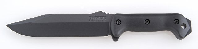

Im not worried about beefy, as much as the hump on the back, and that very rear angle. Wish it was more like Becker bk7. You can make the handle at a slight angle compared to the blade, but not put that palm hump in the back, which creates a hot spot for me. Like the LC has.
IMO it does nothing to aid in chopping. I know the hump and angle is supposed to be there to aid when grabbing the knife with two fingers in the back in order to have more leverage, but personally I never hold my knife with two fingers.
Also the bottom where the fingers wrap around, the FK has a nicer sorta S curve to it, where the front finger indentation is equal to the rear, whereas the LC is shaped like you can put 3 fingers in the front, and the rear one just kinda hangs there.
In other words I wish the bottom of the handle was shaped like the FK, it is far more comfortable. Like a Becker bk7 basically.
As far as the width of the handle looking from the top, I think the one in the picture is about perfect. If he goes any thinner, he'll probably have to give out separate spacers for people that have big hands.
I really like the custom thickness of the blade, and materials/heat treat, but if the handle ends up being thin in the front hump in the back, I'll probably have to wrap some cord around the front in order to make it the same width as the rear (looking at the side of the handle). Something that Lorien showed in one of his photos/similar.
Unfortunately, that still wont help me with the hump.
The hump simply fills the palm of my hand better and leads to less forearm fatigue when I do extended chopping. For me.
Looking at the BK7 :
A straight handle like that might nest better in a sheet (for the steel) or allow the knife to fit in a smaller bar and is more simple to model, and I certainly understand everybody has different hands and preferences, but to my hand such a straight handle like that doesn't work as well in extended chopping. Please understand our handles are not shaped the way they are for stylistic reasons or aesthetics, it is purely an ergonomic pursuit, though I don't expect it could ever be perfect for every person. My personal preference is to avoid knives with a straight spine, I find them uncomfortable, and a design like that puts a lot of work on the pinky which starts to hurt my hand after a while.
But it sounds like you've spent a lot of time coming to your conclusion, so I do respect your opinion. :thumbup:
