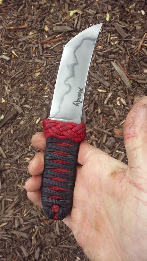

I like the black hamon, but here is a video of a non etched 2,000 grit edc. It's off my instagram so it loads kinda slow, but I like it enough to share lol
.[video]https://www.instagram.com/p/BM9Yvm0D3UP/[/video]

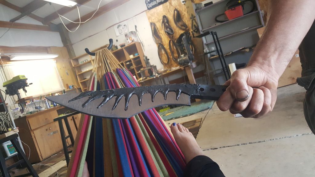

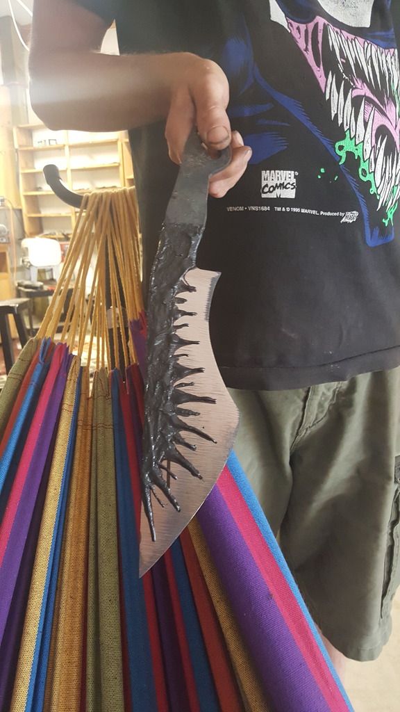

Here is a clay layout. I use Rutlands. The steel is 1095 and is at 220 grit at .04 thicknesss.
Here it is finished.
I finish grind a knife this size to .015 and hand sanded it to 800 grit.
Etched in 50/50 ferric/vinegar for about 45 seconds.
Then I use soft pieces of leather about 1" square and Old #7 made by turtle wax and I rub the $(%+[¢√ out of it and get off as many oxides as I possibly can.

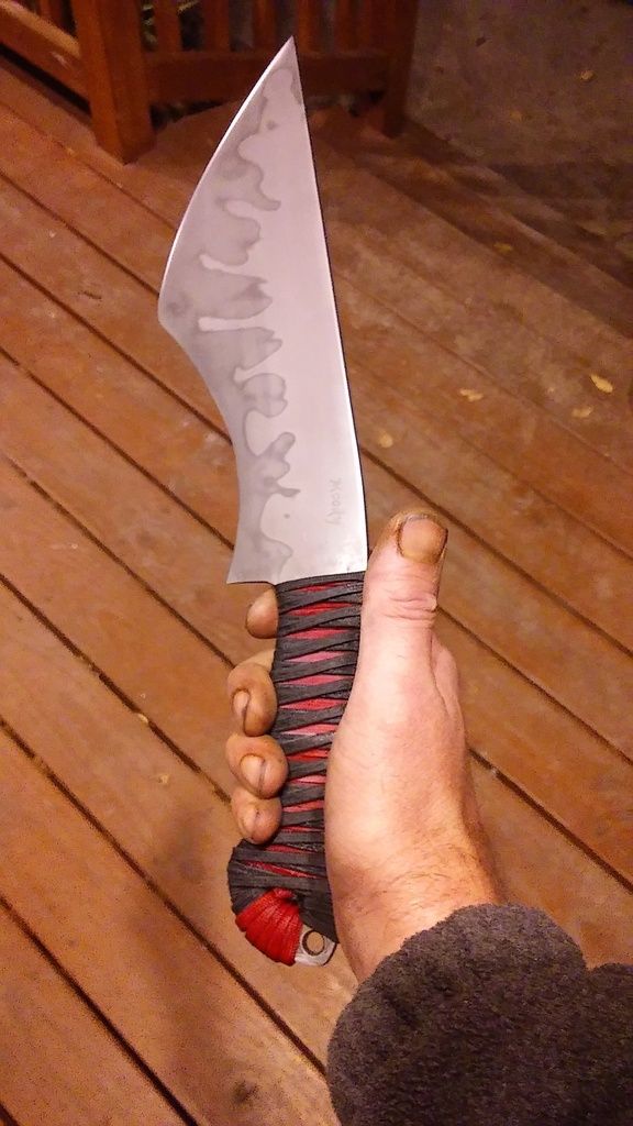

Here is another example of the same profile, steel and thickness. I did one thing different; I interrupted the quench.
And here it is finished. Same type of finish, but much more activity after the interrupted quench.

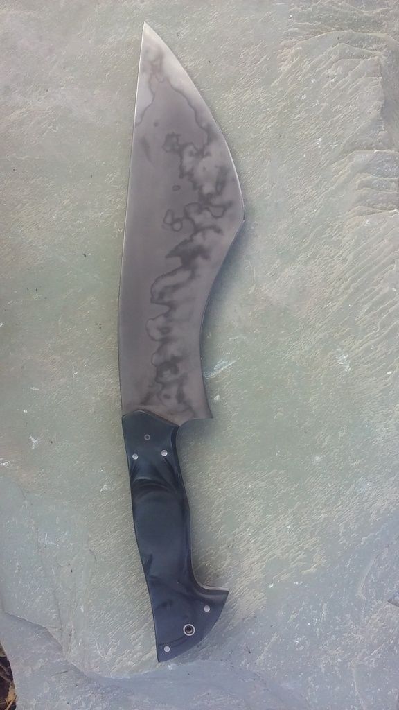

Another black hamon. I know the purists will cuss and swear, but I don't care lol
