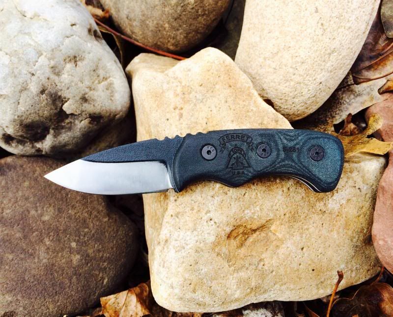

Still getting daily use to include opening packages, cutting tubing, fruit, etc. I have convexed the edge to a nice sharpness and polished the edge using a leather strop. The blade hasn't needed any touching up from daily tasks so I just oil it here and there. The micarta handles are darkening up a lot up front. Probably from oil, dirt, fruit juices, etc.
Here's a shot from today:

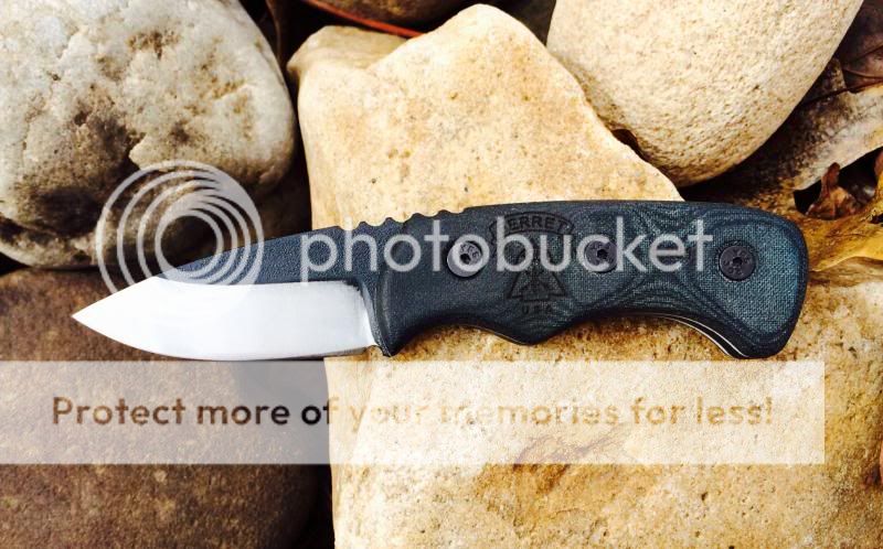

After some cutting boxes last night I decided the edge was still not what I wanted. Just a bit thick at the edge for a little slicer. I am currently, slowly, reprofiling the blade to more of a high scandi grind since my most razor sharp knives are Moras and I FREAKING love scandi grinds. I figure a little 1095 blade like this will be an absolute laser in a high scandi configuration. We shall see. I love to tinker around till I get it just right for me. I have it about 60% done so stay tuned for some pics of when I finish. Like I said, it's a small blade so I'm going very very slowly.
Ok, well I'd consider this about 80% done now and I'll probably stop here. The grinds were slightly hollow ground it seems, so I took it only until I had a true zero edge with no microbevel. I did this by laying the blade flat on my stone then tilting the blade till the edge rested on the stone, applying pressure on the edge I worked away (the same way you sharpen an already scandi blade). It's definitely a fantastic slicer and quite a laser now. Given that it is 1/8" 1095 it is still quite strong and very robust.

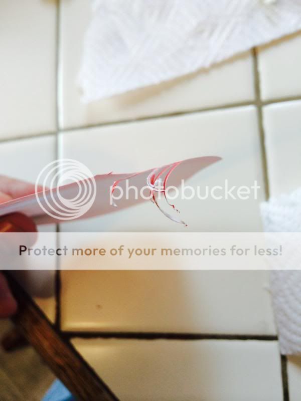

since people like to see paper sliced hahaha:

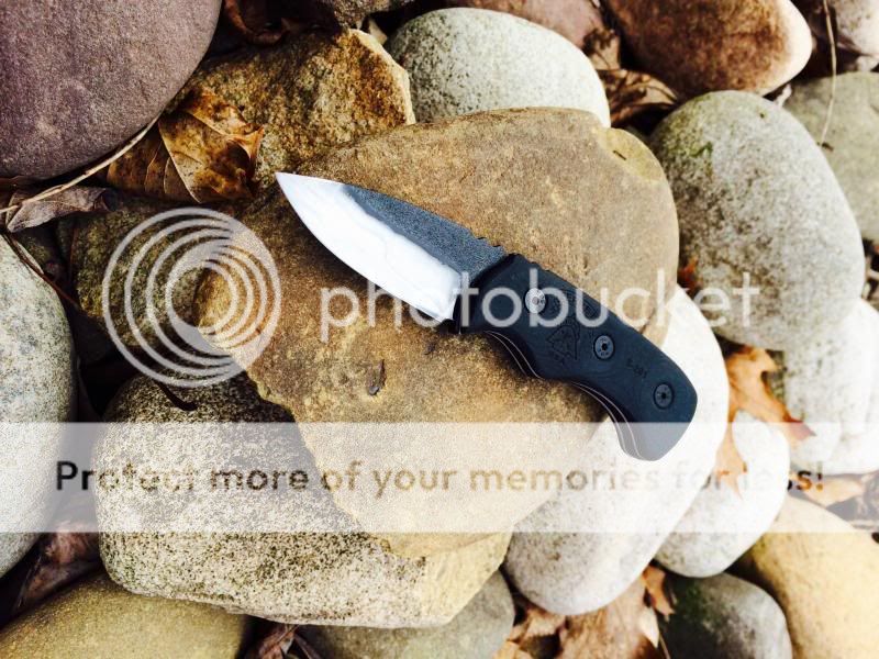

You were right I am really enjoying this knife, mine wasn't overly sharp when I got it but after 10 passes on the strop it is now
I like how it doesn't feel small
Awesome MadIndian! I know what you are saying, it really doesn't feel small in hand and is very easy to use. Enjoy that blade.
Thank you sir! It is very "slicey" now hahaha. I love this little blade. My wife told me this AM to leave it the heck alone, it's perfect. The lady wins. Frankly, I think she just wants me to stop playing with the darn thing and pay more attention to her. In all honesty I really am happy with how it looks and it cuts so well that I'm not going to mess any further. Now it's purely a use item. I'm going to let a natural patina build over time.

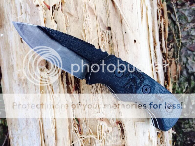

Everyday so far, on the weekend it replaced a folder that I usually carry as a backup to bk11 and its replaced my mini paraframe as my nyc carry.
Very happy I saw your thread its what swung me, doubt I'll strip it like you've done but I do really like how the last one turned out you did, very nice how the line follows the blades cutting lines

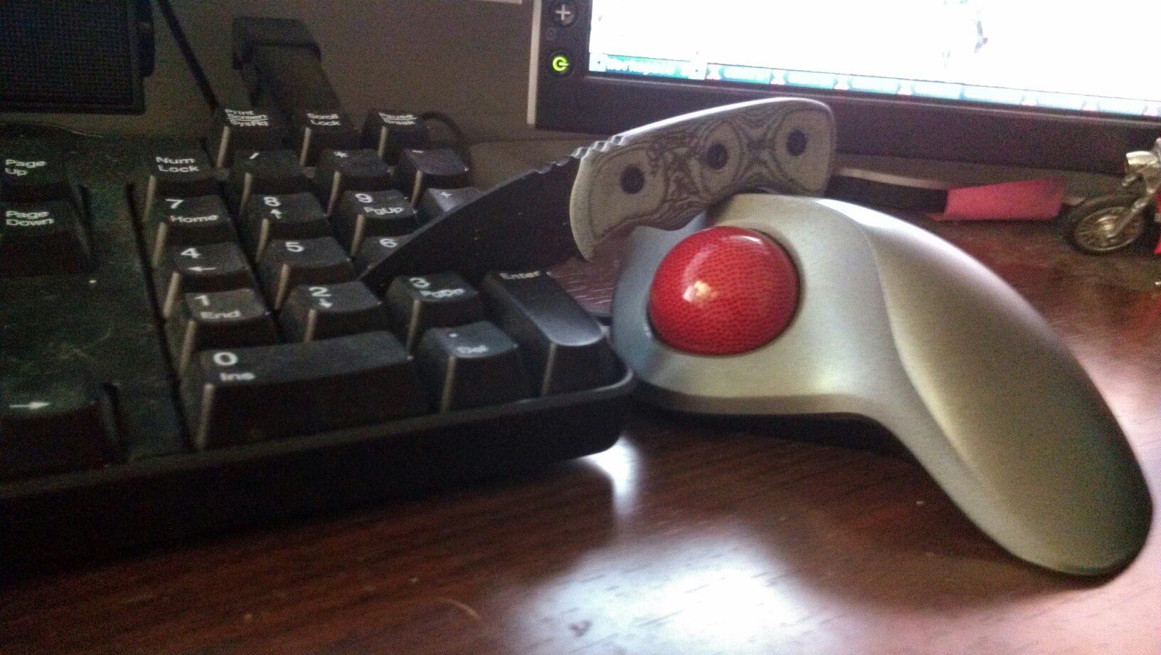

Protecting the keyboard and mouse at work today ;-)
Hmm....ferret protecting a mouse, odd. That's a fine looking blade. Glad it found its way into your pocket. It has such a stout feel for such a tiny blade. Post pics up in here as you use it more and/or modify the knife.
