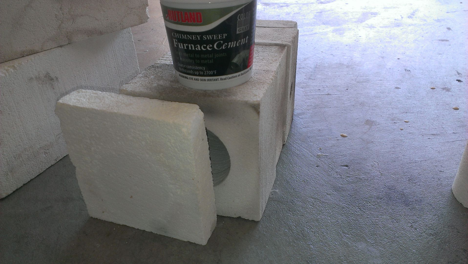

You can use Satanite as well. Not bad to have around for HT work.
Hey, I found this thread through google and i see that its pretty old, so hopefully you will reply still.
I was looking into building this, and its looking like the best option as to it only costs about $80
I just had a couple questions. 1) If i just turn full bricks sideways, would it still be able to have enough heat with such a wide hole?
2) Or could i just add more half bricks to the front, to make it a little longer on the inside?
3) About how big should the exhaust hole be in the back, and should there be any specific spot that i put it?
Thanks for the help buddy!
