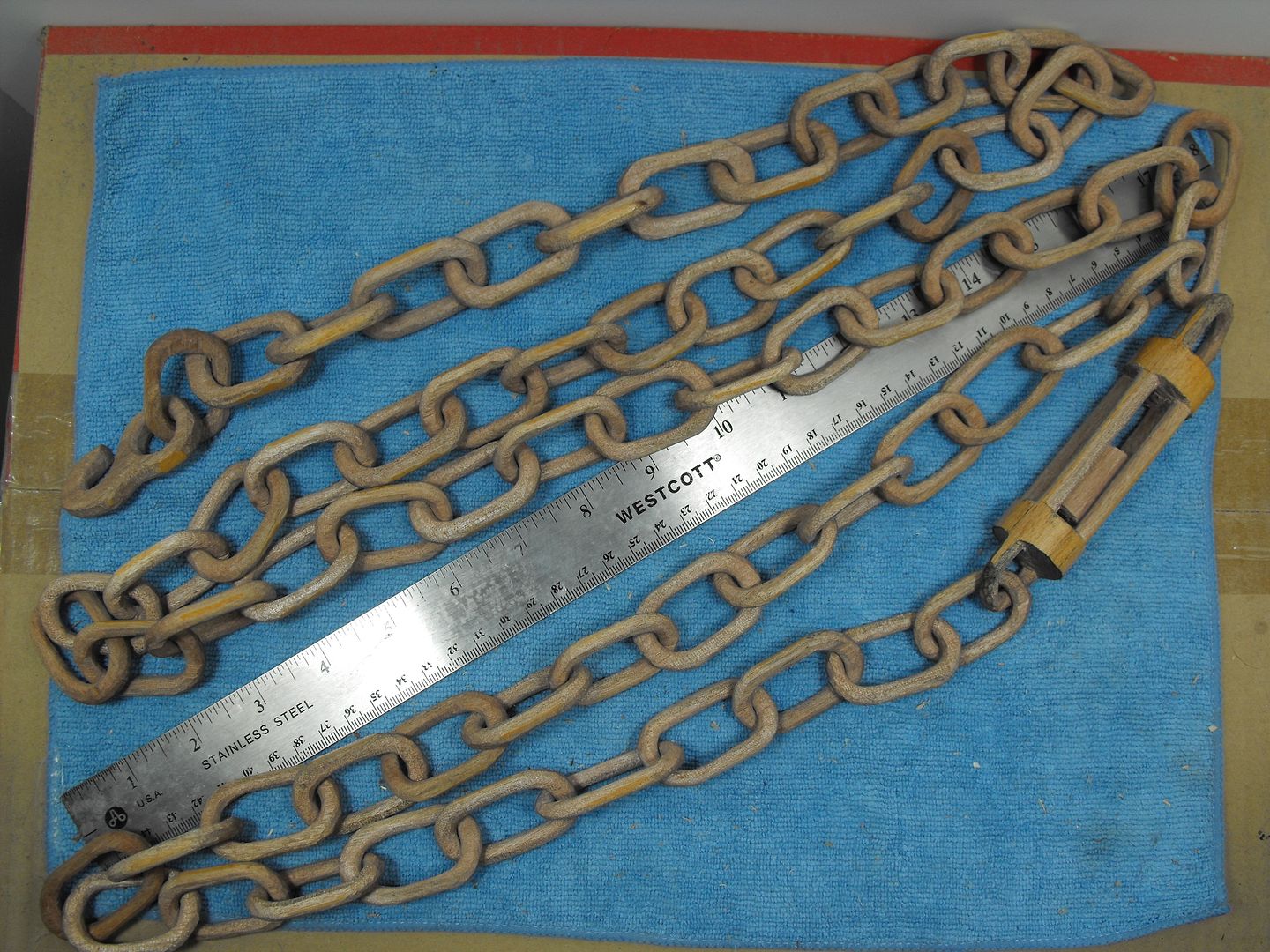

You do realize the post you quoted was almost two years old, don't you? The early issues have been resolved. I own two, one of the originals that the edge suffered extreme damage from whittling on basswood, and a factory second with the added 30° secondary bevel that has had no problems, even on very hard, knotty wood. If you want a folding knife for woodworking, the Nilakka is the best you will find in Spyderco's lineup. I did this project almost entirely with my original Nilakka after I convexed the edge.
