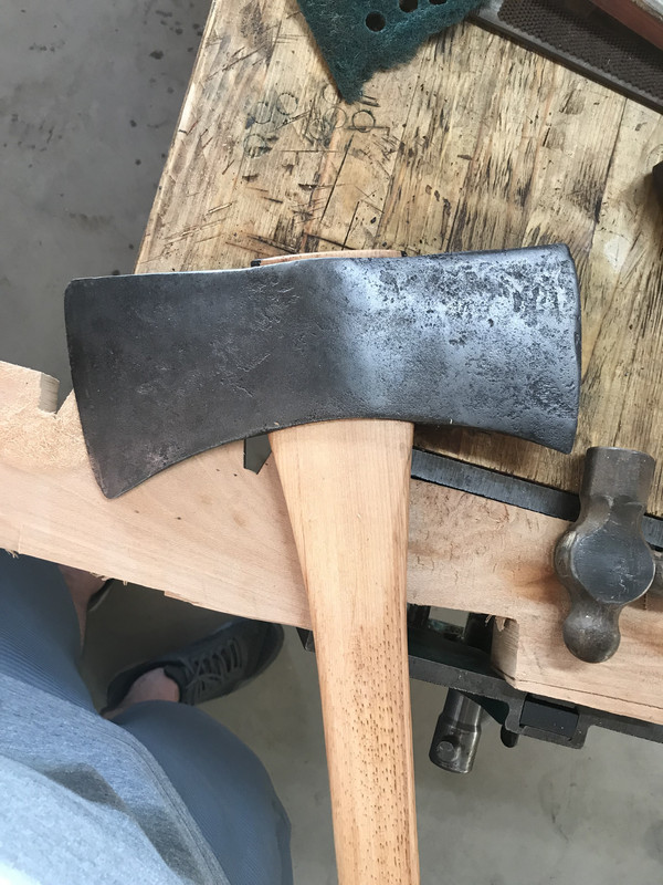

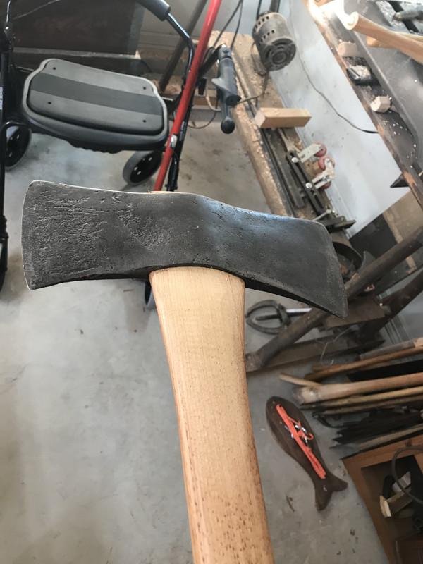

These are my two most recent hangs. This was an ax I bought from an older Gentlemen from New Hampshire. The only marking I can find is 3 1/2. It has a great shape and great profile and shows it’s age. Are used a new old stock link handle and a nice hand carved walnut wedge. I have soaked it in boiled linseed oil since these pictures.

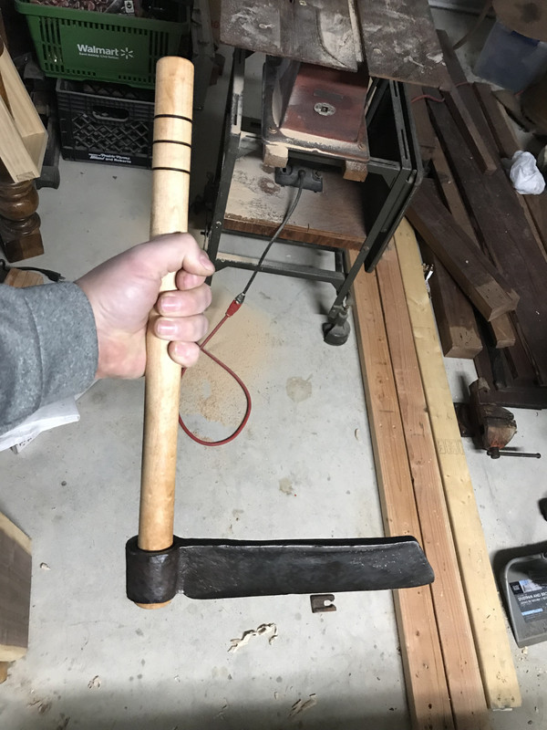

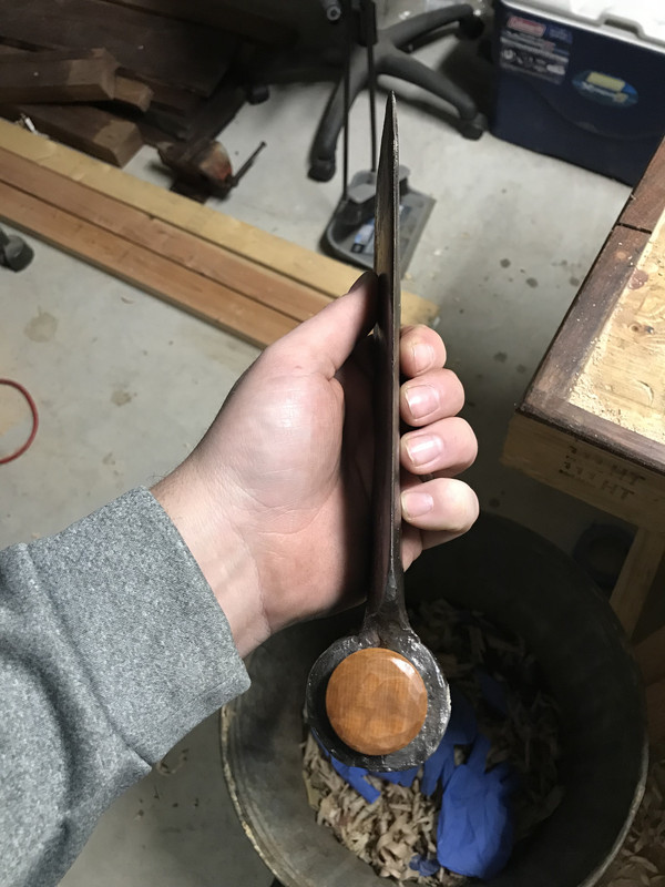

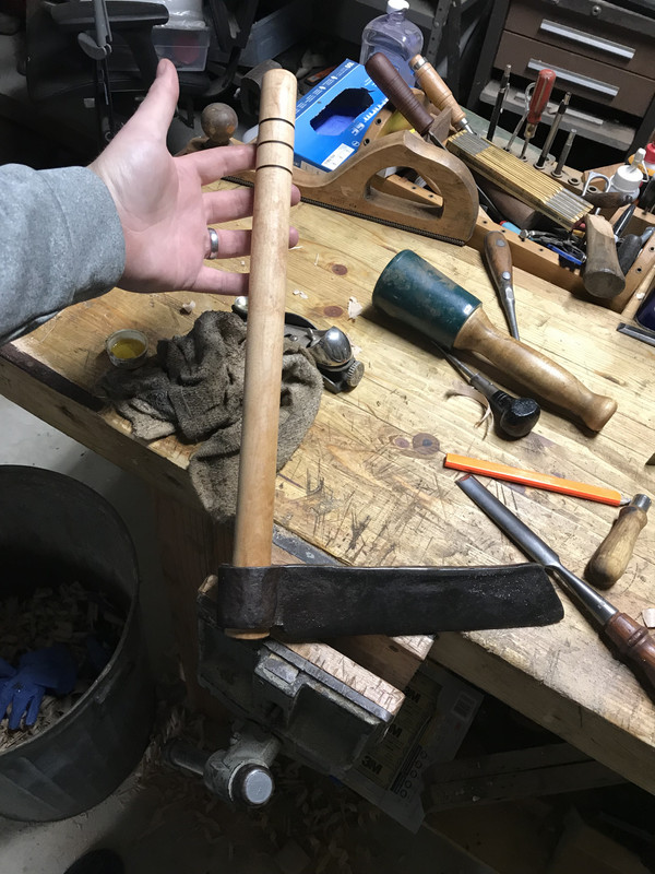

The next hang was a fro that I found at a sale at a cabinet shop. It is hand forged and has a wonderful profile. Are used a chunk of oak on my leave and turned the handle. Thanks for looking!
Brian Rust--The froe is a great, single purpose tool to use. I see your "wood is good" mallet. When they first started to sell them I bought one of every size and said "I will probably never use these". Well, now that I am older, and my hand surgeon told me that I used my hands up making a living, I use the "wood is good" mallets all the time.

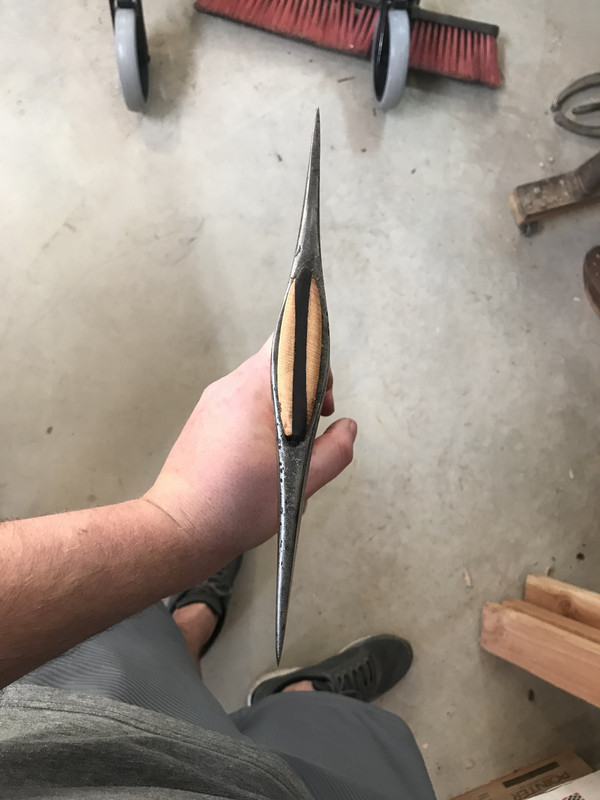

I rehung this plumb boy's axe on its original haft since the haft loosened. Amazingly, the head was loose in use but the @#$* Perma-bond was @#$%^&* TIGHT! I ended up drilling relief holes all around the eye to break its bond on the head. Then I seated it, kerfed it, wedged it with a Brian Rust walnut wedge, and cut the wedge flush. The haft had so little wiggle room it was flush with no cutting required.
