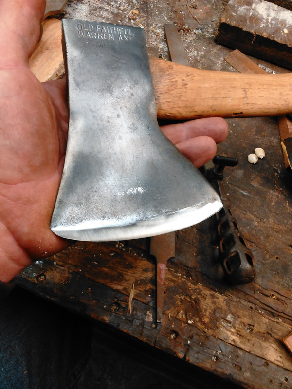

I think I went far enough back with it. I could still go back further of course. I didn't use a straight edge while filing. Just by feel and by eye. I'm curious if you think it'll work fine as is. Here's a few pics of that;
The other end has an identical flare.
The end on the back that had the worst pitting isn't perfect but it's close. Here's the back with a square placed on it at varying distances;
Another thing I'm curious about is that black paint. I immersed this in evaporust twice! And it hardly touched that black paint. Could it be lead based? It's always removed any and all paints before but not this time.Tough stuff!
And I know it's not perfect but I think it's serviceable, no?
Edit; in the 3rd photo I had the square slightly tilted away from me. I just repeated that placement and it sits flat to the edge. The 1st one however is tapered down slightly. :( Almost! :p
You're good. It should work fine. You're plenty flat in the bit-to-poll direction.
Old Axeman has spoken of the benefit of having some curve from heel to toe. This raises the tips in relation to the center of the bit and prevents the heel or toe from digging in. It makes it easier to create a smooth finish on the work.
Oh, and the black paint is likely japanning.
