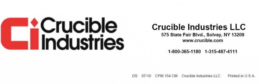

Saw this:
http://www.crucible.com/PDFs/DataSheets2010/Datasheet CPM 154 CMv12010.pdf
Yeah it's at the bottom of the sheet, in small print because when they 1st started making CPM 154 they called it CPM 154CM so the makers could relate to what it was since it was a new steel then.
What happened was it confused people more than helped so they shorted it to CPM 154 for the powered vers.
So there really is no steel called CPM 154CM and if it's labeled that way today it's in error.....
That's my understanding as well. But I stated that the term "CPM154CM" did not appear anywhere in official Crucible literature and I was wrong. There's just no wiggle room in that.

Sorry for all of the confusion in regards to the naming of CPM 154. Peter is right that the nomenclature is CPM 154-CM on the material certificates. One way to tell if it is CPM versus airmelt is to look at the heat number. All air melt heats start with the letter A. All CPM heats start with the letter P or H. I know this does not help you if you are buying a knife from someone who etches CPM 154-CM on the blade, but it should be verifiable if you buy the material from one of our distributors. We provide them all with the mill certificate and they should be able to send you a copy upon request. We will contact our distributors to see if they can all name the grades either 154-CM or CPM 154 to eliminate this problem.
