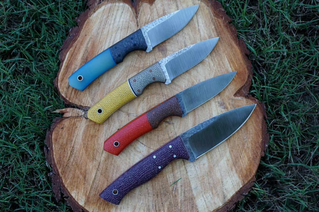

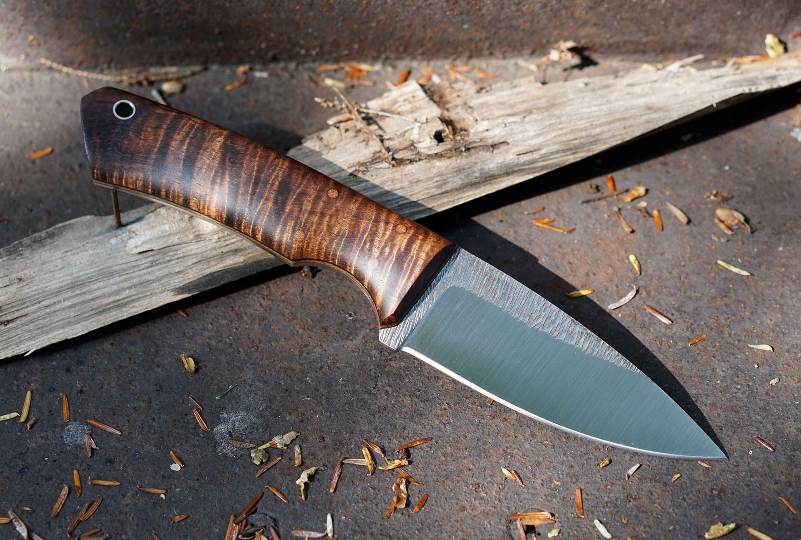

Preferring the lanyard hole centered top-to-bottom vs up in the corner is a personal thing that I may have mentioned a time or six in side conversation but I don't think I ever asked why. The pics below are borrowed from one of your threads and the older knives seem to have centered lanyard holes and the newer ones have the lanyard hole up in the corner. Is there a functional benefit a user would get or does this make the knife making process easier .. why did they migrate? :D
Also curious if other OKT fans have preferences one way or the other.

It was a combination of functionality and asthetics, I personaly do not see the point of a lanyard tube on most knives except for the ones that you are going to be swinging I.E. choppers, machetes etc. When it was explained to me by someone the purpose other than retention in the hand when swinging a blade and used mostly as an extension of the handle to draw from the sheath or grab from the pinky, it made more sense to me to place it at the top half of the handle where your pinky would come to rest in a closed grip, also I feel it places it more out of the way when not using it for this purpose if one did still have a lanyard through the hole.
Astheticly speaking it was a decsision to steer more away from the Fiddleback layout of things to distinguish my style more.
I hope this gives you the answer you where seeking and explains my thought process behind it more.
Personally, I never use lanyards. I've tried 3-4 times on a handful of different knives. They just get in my way, no matter what size of knife. I ended up giving up on them. These days, I prefer lanyard holes centered like Jerry does, but even though I don't use them I do appreciate the aesthetic they offer, especially some of those carbon fiber/ micarta/ g10 ones. I find that even the highly placed ones on Chris' knives look damn good, despite my normal preference.
I am the same way, and the only knife I really like a lanyard on is a Swiss army knife. Choppers for security only if other people are nearby, otherwise be smart and take a break if you can hold on to the tool. No added value for me on smaller fixed blades.
I do like the lanyard tube being present on a knife though oddly enough. Centered or offset does not really matter to me, but aesthetically I think Chris has them in a good spot on his current knives with the types of tubes he uses and style if handles. Tied lanyards should hang pretty similar either way
You know how it doesn't serve any function to hold the lock open on a Griptilian and mindlessly swing the blade back and forth .. just playing around? Well, I don't like or use lanyards either (maybeee once in a great while, depending on the knife) but I do like to get a pinch grip on a fixed blade by a centered lanyard hole and swing it back and forth.
In some cases you could use that centered lanyard hole to change grips on the knife. But if it's up in the corner then you can't get a good grip on it and you'd probably slip off and drop the knife.
