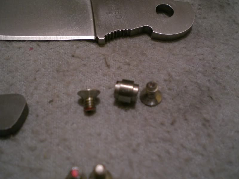

Is it the presentation side that has that "step" in the pivot or is it the clip side? I can't remember. I need to tighten up my pivot just a hair and I don't want to tighten the stepped side...
The clip side pivot screw is the one that's locked in, don't try to turn it. You turn the presentation side

I don't understand what you're saying. The pivot bushing is notched on one side, but neither screw is notched and both are adjustable. The purpose of the bushing notch is to prevent the bushing from spinning when turning the screws... regardless of which screw you turn.

Again, the notched bushing has nothing whatever to do with which screw you can adjust. Neither screw is "locked in". You can adjust both.

The bushing is stepped on both sides. The only difference between one side and the other is that one is notched with a small flat portion to keep it from spinning. Both sides have screw, scale, liner, washer, bushing, blade. So I can't see how it makes a difference which side you adjust.
Maybe pics will be helpful here. (These are not my photos).
Here's a picture of the bushing, stepped on both sides:
Here's one of the notch on the left side of the bushing. Note the flat portion.
Yeah, maybe I worded my post wrong. What I meant by stepped, was that notch. Personally, just how I re-assemble, I always put the notched side of the bushing with the washer in first and lock-tite it in place.. Now the liner, washer and bushing are basically one "assembly" so to speak. I adjust the other screw, which pulls or looses this "assembly", tightening or loosening the action of the blade. Am I making any sense? I can't really put into words, but my notched side of the bushing always gets lock-tited and never gets touched again.

What I don't get is k_ozdragon saying there's one screw that's "locked in" and you shouldn't try to turn it... :confused:

yep. i didn't take mine apart but i tried to tighten the pivot as their is a hair of side to side play and it's red locktighted and it's not gonna budge to loosen or tighten. very disappointing. i
ll have to rectify that myself and reuse blue as should be used for a pivot.

They all have loctite, but I've never seen the red loctite on one. Red is the permanent loctite. Usually blue is used.

I suppose I shouldn't say it "doesnt" turn. As has explained, the bushing is notched on that side. So turning that screw serves no purpose unless you're completely taking the knife apart; however even if that's the case it would still the the last screw to remove. If you loosen it to adjust the pivot, then ghe bushing can come lose. If it gets too loose it'll spin and offset the pivot and scales. It needs to remain tight, so pivot adjustment is done by the non-divot side. Basically it's a screw that never needs to be touched or adjusted. Also, Spyderco tightens this screw very tight to hold the pivot in place. As such, many people damage the knife trying to remove it. Many others also hold both screws believe in god that if they don't they can't loosen them from the pivot, which is obviously not the case and makes the job much more difficult. Plus if you do happen to loosen this screw first, you cannot remove the other without holding the pivot somehow and possibly damaging it. So basically that side of the pivot is "locked in" and should never be touched unless you are doing a full disassembly and removing the scales.
