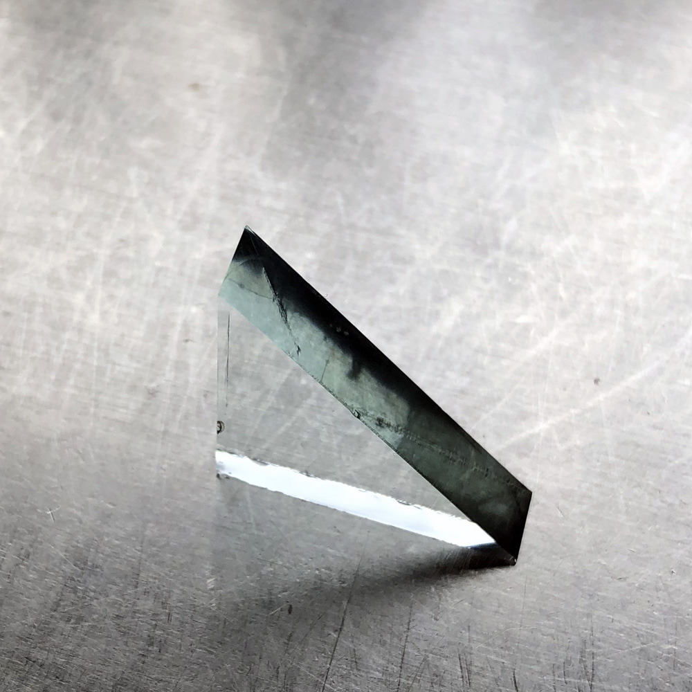

One of the most polished (or rather smooth) edges with the edge radius around 5 nm (this one is used and probably not that "sharp" anymore).
It excels in push cutting but doesn't seems to have any slicing aggression and slips on skin.
