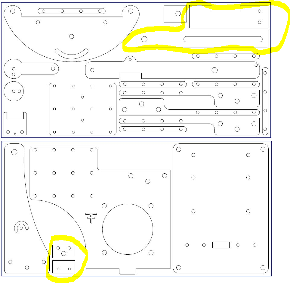

As a point of reference for anyone looking at this, I shot the Cad files (thanks Kevin!) to a waterjet guy locally and was quoted $385 including the material.
Kevin, can you take a couple photos showing what these pieces are for? I understand the top two are probably work rest somehow...?
Those are remnants from the original EERF plans and I believe as well that they are for a work rest. The two largest pieces are the work table and arm that would be bolted to the tool arm. I never could figure out how that was supposed to work. Regardless, since my revised version provides 2 tool arm slots, I just made a rest using a 1.5" square arm. It's 2 blocks (that I cut from the proposed work table piece) welded to a 3/8" plate for the table. Each piece has a 1/2" hole for a solid rod and set screw holes drilled and tapped to secure the rod in these blocks. The rod runs through a 1/2" hole in the solid 1.5" square tool arm for the rest. it can tilt forward and back and slide a lot side to side. I thought that might come in handy on long blades. Hope this helps.

Ok cool, would it be possible to just delete these pieces from the file? Its not much but it is a few less inches of cutting which does reduce cost. I had this grinder cut out via laser a couple days ago a learned a few things. This is just my experience so it shouldn't be taken for gospel, other machines/processes may vary. Apparently, with laser you aren't supposed to cut holes where the diameter is less than the thickness of the material. It leaves a lot of slag, I think maybe due to heat build-up. Also, because of this heat build, a lot of my the long thin pieces came back warped. Cuts were not very clean. I really thought this would be good solution, but it was a little frustrating for me. I'm going to have them re-cut some pieces maybe in 1/4" instead of 1/2" and then just drill the holes instead of trying to pierce them. Annnnyway, just my .02!
This is good information. I water jet cut mine. I assume the pieces in question are the long thin pieces with 4 holes each (6 of them) if you go with 1/4", you will need 12 of those, since they create the pocket for the tool arms( three- 1/2" spacers = 1.5" pocket). If you want to drill them, print out the PDF full scale and use those pieces from the print as a template for drilling. You MAY also be able to use steel tubes 11/2" long, 1/4" inside diameter and 1/2" outside diameter to use as spacers. You would need 12 of them.
Rule of thumb with laser is holes equal to or greater diameter than material thickness. You can deviate from that. Some steels cut better than others, using nitrogen instead of oxygen reduces heat and thermal runaway.
In 1/2" A36 it's tough to get smaller holes or great cut quality even with a high end laser, in am all holes or cross section parts.
You could ask them to etch those holes rather than cut. Then your drill locations are marked.
Most plate has a lot of stress in it and simply cutting parts from it causes them to warp, it was a coil before it was a plate.
Kevin, yeah I would double up the quantity on the 1/4" plates. And yes, you are correct about the problems being with the linear spacers. I hadn't considered using a tube type spacer but that is a good idea!
Kuraki, yeah that is the info I learned after the cut...! It seemed like he said they were using nitrogen for the diode cooling and oxygen in the cut. He also said that if I need him to recut the pieces he will just use the laser to etch the hole centers and then run them through the drill press.

the tracking mechanism hinge pin holes need to be drilled by hand anyway, as do the holes in the arm to attach the mechanism. I would just do those all by hand. I actually wound up slotting the holes in the mechanism that mount it to the arm, to give me some adjustment of the plane of the tracking wheel to the grinder body. This way, if your tapping of the tracking knob hole or the holes in the tracking arm are off (or anything else is off) you can get the tracking wheel back in plane. It takes very little angle at this piece to make a big difference in how it tracks. I imagine this is the same case for most grinders, and the reason the Reed products grinder has this type of adjustment built in. Oh, one thing on the build. I don't think i documented, but depending on your tool arm material, you may need to shim the tool arm pocket spacer with thin aluminum (like a beer can). I found on mine, that solid aluminum bars are a bit large for the pocket, and solid steel are a little small. I imaging this can't be helped with different tolerances for tool arm stock. I would recommend using solid aluminum and shimming, as the aluminum stock seems more consistent, and solid steel bar arms are HEAVY.
here's a picture of a different grinder using the tubes, I've seen others. Tube should be strong steel and you can size them to length to get a nice fit on the tool arms.
