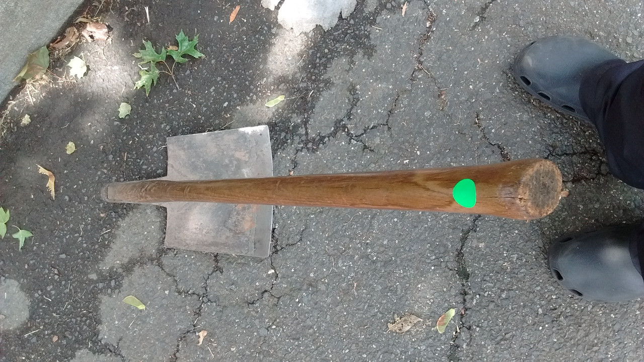

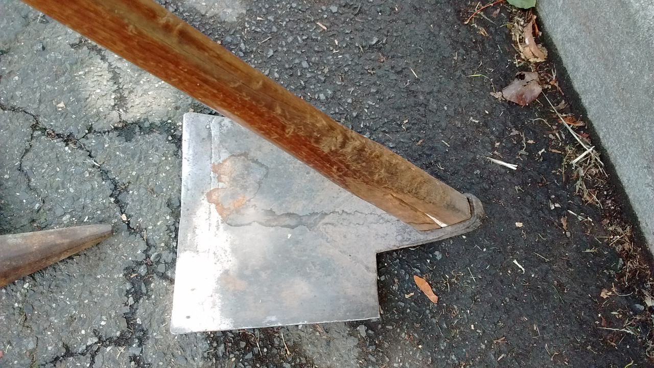

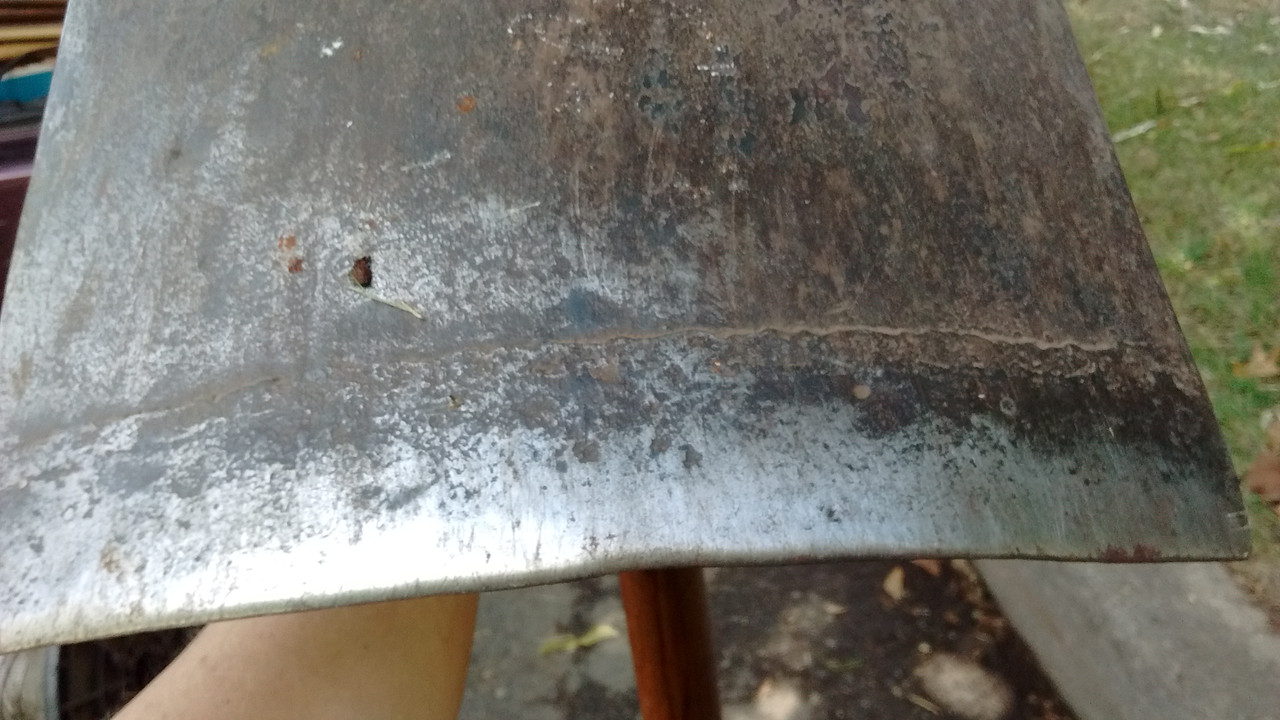

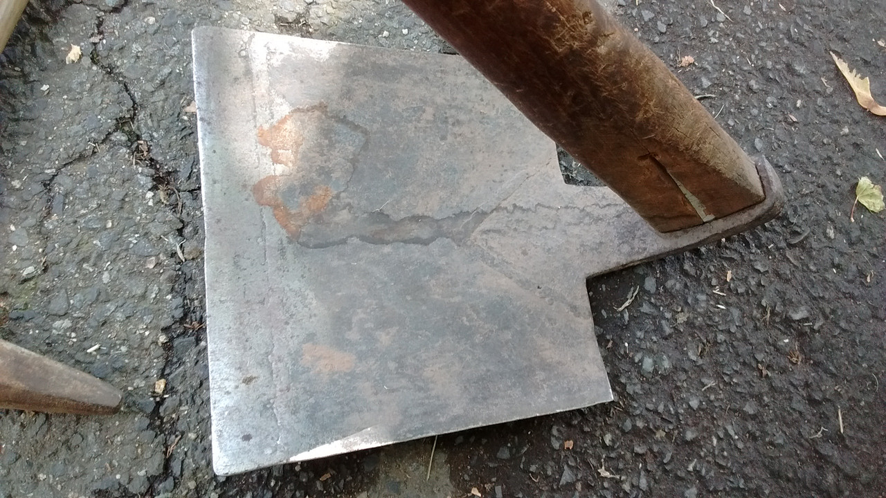

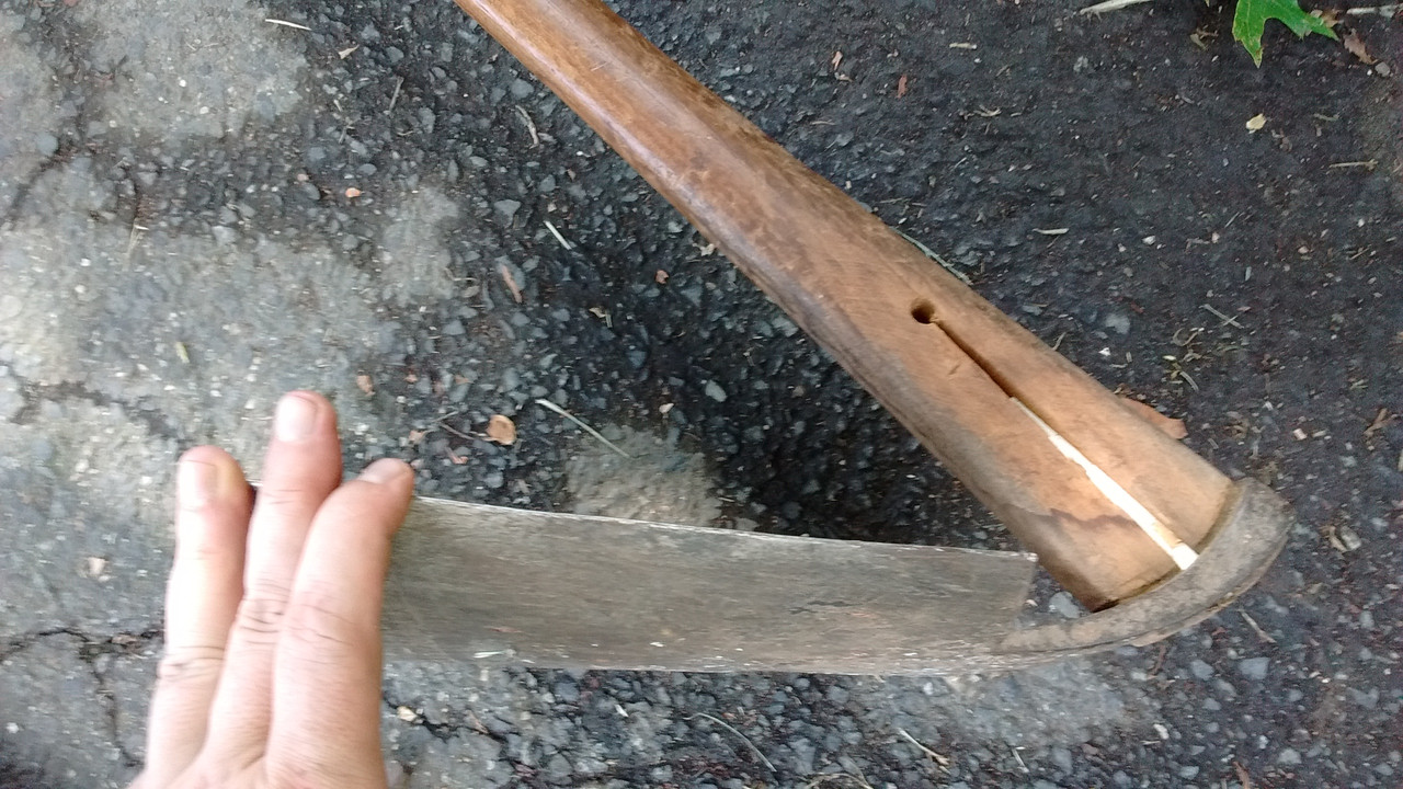

One of those cases: I had to buy it cause I had no idea what was the use for such a tool. The edge is harder than the rest of this "Hoe". The angle of the haft gets me thinking it is more of slicing/pulling than chopping tool . The owner was first generation Croatian; maybe the shape of that tool has Balkan roots
Really good finds! There's a bunch of neat stuff there. Haven't seen too many disston levels. Am I the only one confused about how that adze is hung? I've been looking at it and it still doesn't make sense!

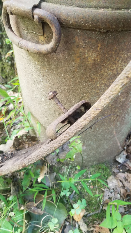

Remnants of a wagon wheel were donated to the forge for possible material.
Woodwork is rotten to the core,parts exhibit traces of lathe,and other mechinised working methods.NO idea how old it'd be.Local steamboat traffic was going strong from 1890-ies,so from there onward till they stopped using wagons,into 30-ies or a bit later...

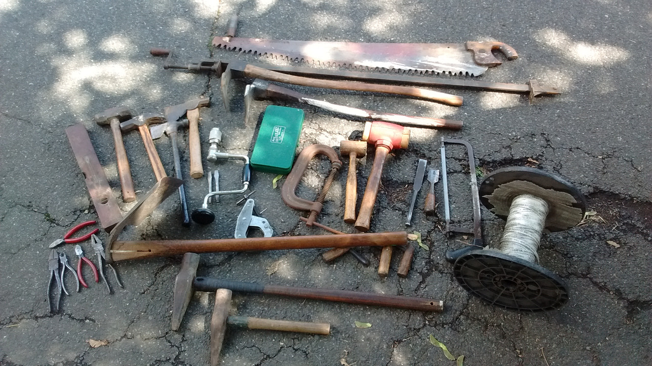

I was reminded of your post of forensics and repurposing of a donated wagon wheel.
Poking around at my parents today...
My dad told me to take it...take it all lol!
We had my wifes car...;)
That large adze-like tool must have been brought in from the tropics. Can you identify the handle wood?
I believe that the haft is actually modified railroad pick replacement handle (most likely hickory)
Also what make is that hammer with round lugs, slightly curved claw and octagonal face? Looks like a really nice hammer!
Yeah I know, that hang is very strange, that is why I had to buy it :)

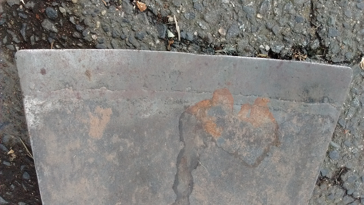

So this is to just show photos of a neat broadaxe:
https://imgur.com/f43q4ac
https://imgur.com/B2YOQDU
https://imgur.com/BhJ6Teu
It appears to be fairly "modern",from the Golden age of American toolmaking.Much competition,very high standards,not a trace of welding on this,everything is ground very carefully;great precision and control over product.
Have to look very close for traces of dissimilar metal joinery.

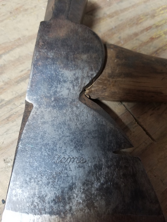

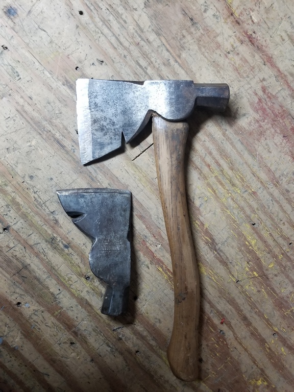

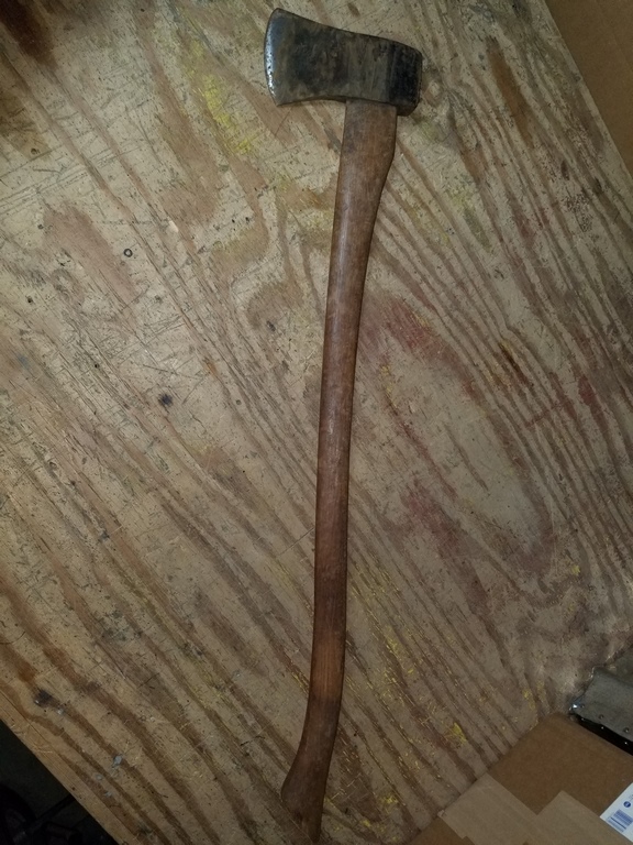

Will you be re-hanging your Acme hatchet? I ask because if so I have a request to ask of you! I got this one awhile back; 15681554896672517121676440373049.jpg

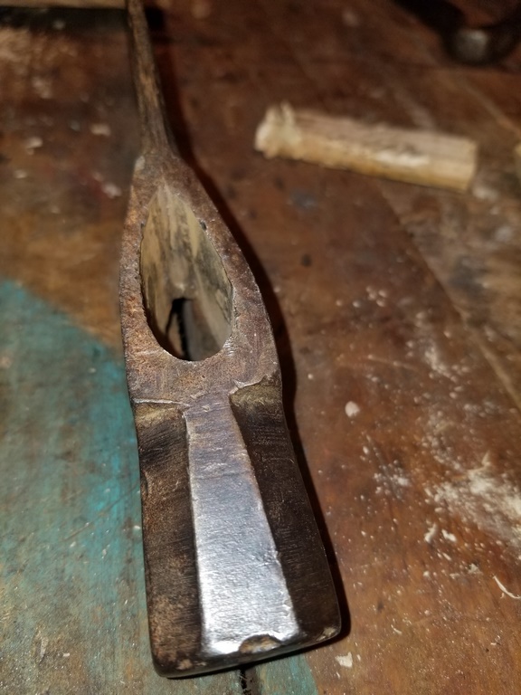

And much to my surprise it appears forge welded! Inside In front of the eye there's a clear "crack"(incomplete weld). Otherwise it appears like a modern hatchet. So I'm just curious and wanted to ask you to have a look and let me know what you find if you do take it off the stick. Thanks! 15681557242743337233326192437221.jpg

Will you be re-hanging your Acme hatchet? I ask because if so I have a request to ask of you! I got this one awhile back; View attachment 1194371
And much to my surprise it appears forge welded! Inside In front of the eye there's a clear "crack"(incomplete weld). Otherwise it appears like a modern hatchet. So I'm just curious and wanted to ask you to have a look and let me know what you find if you do take it off the stick. Thanks! View attachment 1194372
