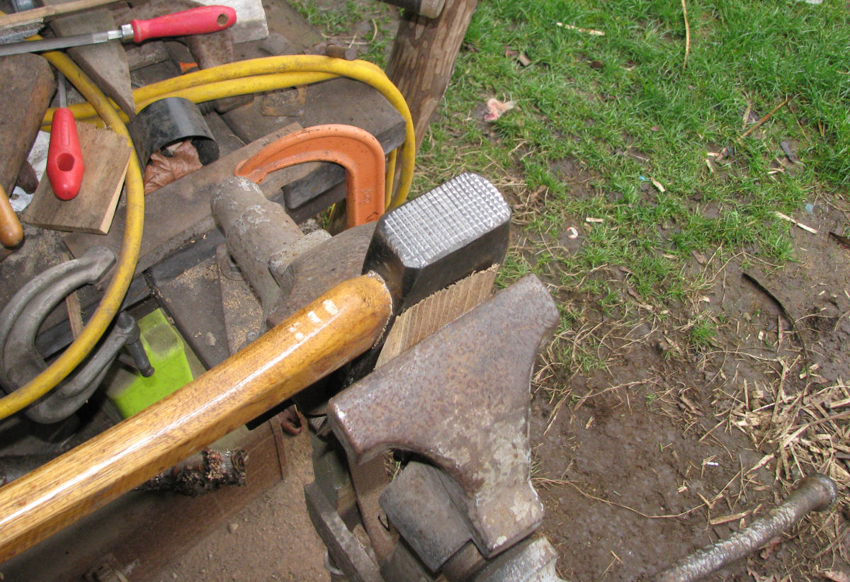

I recently posted a picture of this axe along side a fresher axe and it made me realize how badly I needed to re-grind the waffling on the poll. It's something I've wanted to do for several years but I held off because I knew it would be difficult to do.
Today I finally got around to it. I started with a cant file (not safed) to re-establish the lines. Later I switched to a triangle file to shape the points and grooves.
Here you can see how I set it for filing in my vise. A scrap of hickory protects the bit from the screw while two elms wedges help secure the axe in the jaws.
In the more worn areas it was really tough to carefully re-establish the lines. Tedious and painstaking. It took me over two hours to do. The file had to be brushed out constantly.

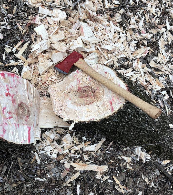

I thought it would be interesting to do a before/after of this red oak I felled last fall. I got more firewood out of it than I thought I would. Almost 2 cord! I took the one on the right.
I finished cleaning up all the small stuff today and splitting all the hard ones. I split all but one with my #5 S&N.
The difficult ones;
And finally the stacked wood. 219.3 cubic feet of it. (That number is wrong see edit/=109 cubic ft)
Have a great night all!
This oak was 84 years old btw.
And it's equivalent to 42,000,000 btu's. Red oak is 24.6 million btu's per cord x 1.71 cord(s). That's a lot of heat from one tree!
I made a mistake when calculating.. There is NOT 1.71 cord there. It's 4/5ths of a cord or 109 cubic feet.
I knew there wasn't that much wood there. I just wanted to make that correction. So about 20 million btu's from that oak. Still not bad!
