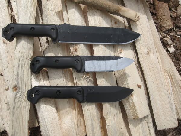

The Crovan steel is super hard, I forgot this and should have posted it earlier the knifemaker who put the thumb jimping on my BK2 had a tuff time here's a copy of his email:
Chris,
I'm finishing up your Bk-2 today. I was able to get the thumb serrations on there but not with a file. A file wouldn't even scratch it. I ended up having to use a carbide endmill in my milling machine and plunge them on. That just about used up one eigth inch endmill to do because the blade was so hard, but we got it done.
Lamont
So endmill bits have a tough time but plastic is dulling it? I gotta say sounds like a too thin of an edge thing to me for sure.
