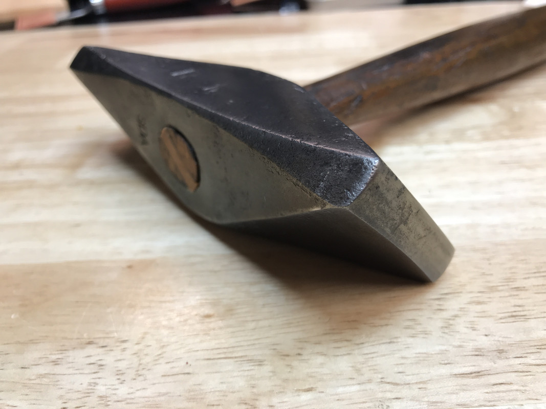

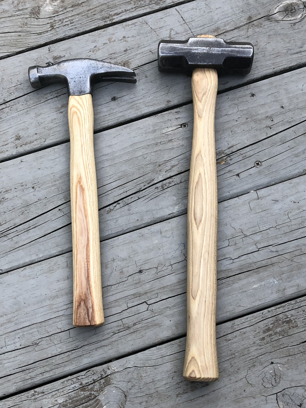

I tried to rejuvenate this cool twist face hammer with a massive chip in it.
I had it welded then did a little sanding and wire wheeled it before redressing the faces with a sanding block.
The repair came out good enough that I keep mistaking what corner it was on. I’m glad he was able to weld it and not have to braze it, so it doesn’t have that gold color.
I considered some other handle options for it but rehung it on it’s old handle with a @Yankee Josh yellow birch wedge.

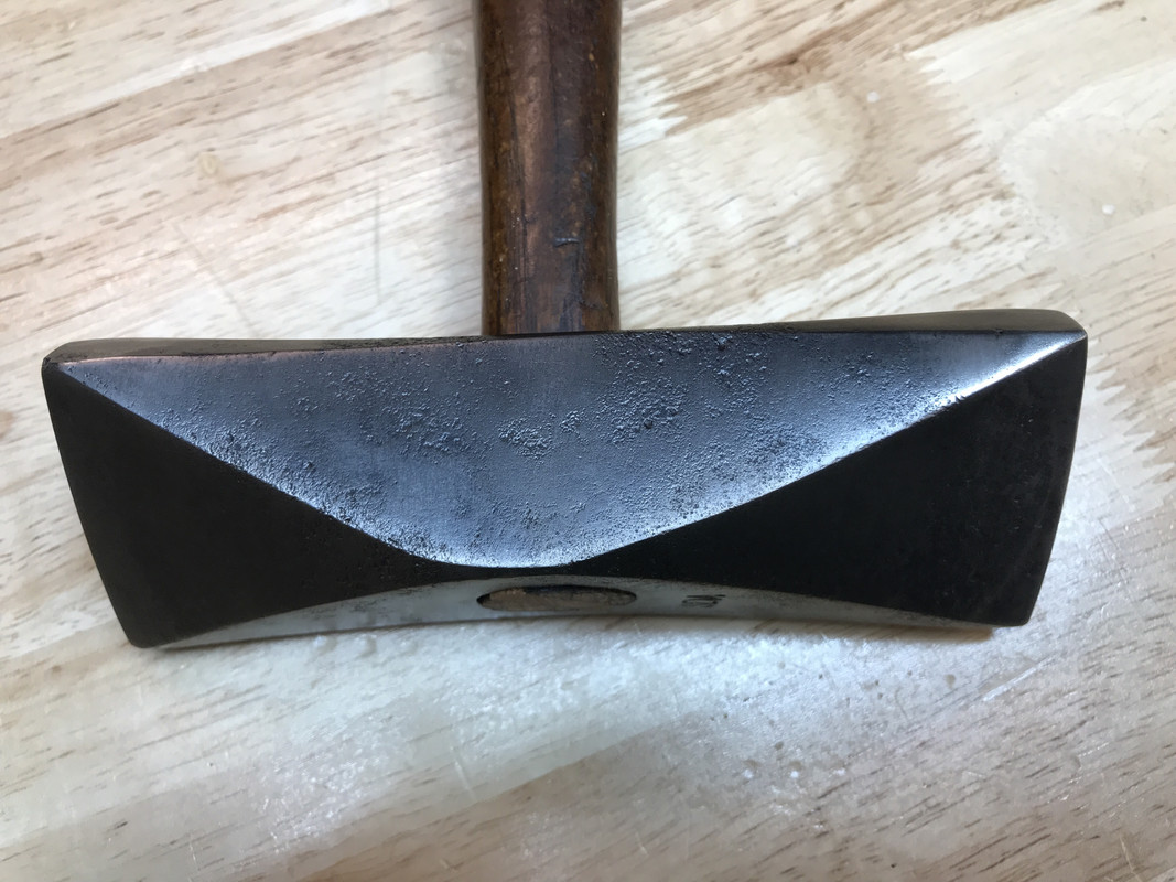

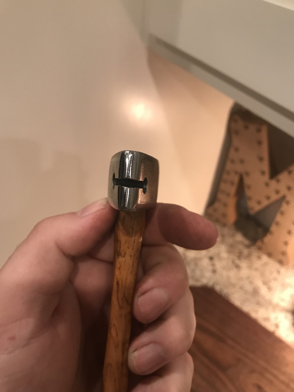

Some closeups of the weld.
It’s hard to capture the funky angles to this unique hammer. But compared to Simonds and other twist face sawyers hammers it has an elegant form. The way the faces are slender and taper into each other with sweeping lines.
Huh, I see almost every shot I took was of the bad corner... that wasn’t intentional. Here is the other face
