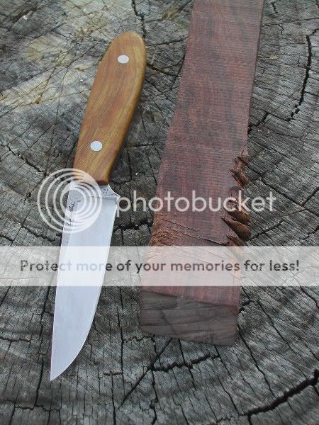

Nathan, now that this discussion has a answer, what was the first pattern you offered?
That would be old the D2 skinning knives:
Test001.jpg~original
Knife making was a hobby 10 years ago that I started doing as filler work in the shop. We only started focusing primarily on knives a few years ago.
Being a hobby I made what I needed, which at the time was a good skinning knife. That turned into a pattern that I offered here on the forum.
Some of the first blades I made were replacement blades for folders to improve the edge retention on knives my FIL and I carried.
Some of those D2 skinners had some of the early low temp, non-secondary hardening, tweaks I became known for. A few were ground down to a very thin, above tangent, big deep hollow grind that you could flex on your thumb nail. They were nearly straight razors with a belly. I enjoyed a ridiculously thin hard sharp knife but some people tore them up.
little known fact: D2 with these heat treat tweaks ended up being used in an industrial cutting application where the carbide blades they replaced were getting around 15,000 cuts in Kevlar fiber (in the jacket of fiber optics cable). The goal was perhaps 5,000 cuts with steel (which was much less expensive than the carbide blades they'd been using) but once we had it dialed in they were getting 250,000 cuts out of a blade without sharpening or any other maintenance. <---no joke, no exaggeration.
