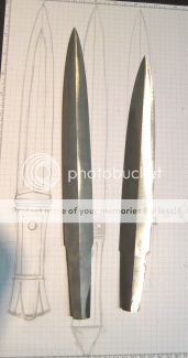

Admittedly it is an aesthetic that was new to me and we exchanged many emails at the beginning to discuss ideas. Then they sat, stewing in my imagination until about September when I began the sketching. Once the blade style was sorted and the suguha hamon (couldn't resist a little Japanese influence... and I'm pleased it came out so centered) it was onto the handle.
I must have drawn 10 versions of this, and then went and sketched some of the jewelry shapes to get a sense of things...
So, once we had a blade and a design:

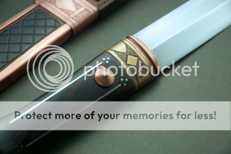

I got to creating the jigsaw puzzle. There were many firsts and many experiments on this one. The fuchi like collar piece, the fitting of the domed copper piece, the inlaid handle and the whole butt assembly, the control of the hamon (much more scary than doing a random wild one), the three piece pin, not to mention the sheet copper work...

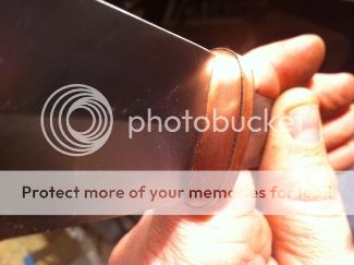

Here's the fit of the domed collar to the blade. I was proud of this so here's a pic. It was, again, more challenging than I thought it would be...

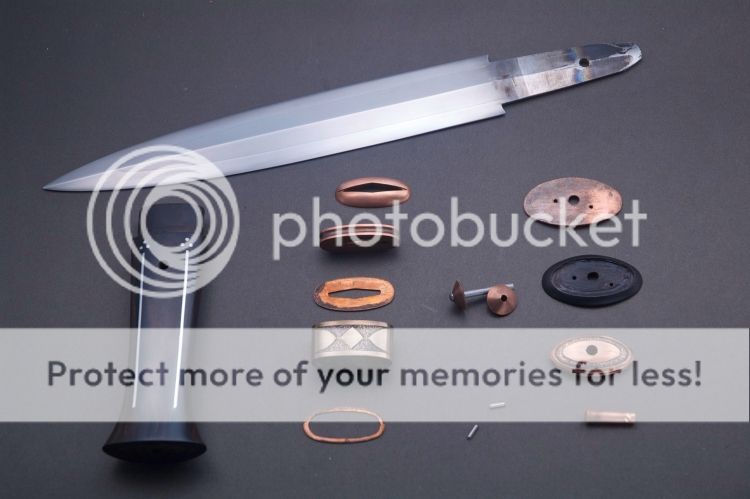

Here's the preassembly layout. 14 pieces, (16 if you could the two little alignment pins). As I said to the client.. Making these took a long time but it took longer to think of them :p :

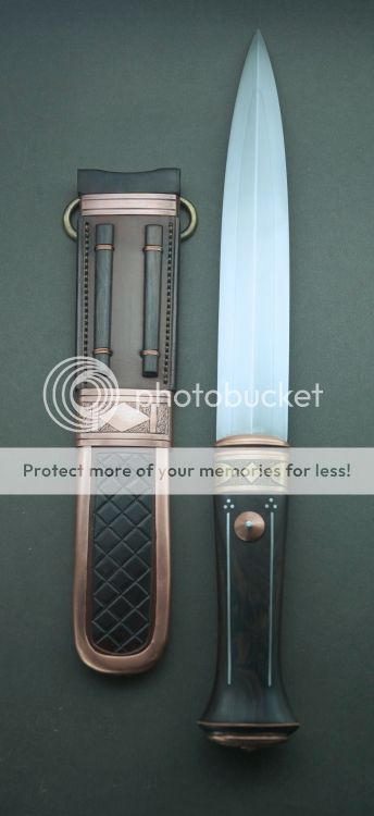

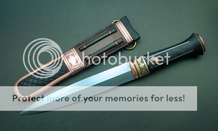

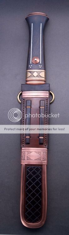

Then came the sheath. I struggled trying to figure out this one. I went with a mix of traditional styling (if you google Tuareg dagger you'll see the influences) but with a leather base and blackwood and copper accents.
Once the idea of the blackwood slats bound with copper came to me, the rest of the design was clear.

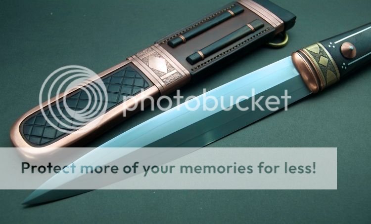

BUT... forming copper sheet is much more challenging than I would have thought. That chape is the 4th try. The problem with sheet is how quickly it work hardens when you bend it so once it's in place and you try to remove it, it wants to bend in an annealed area, completely f*%#ing things up... Man...

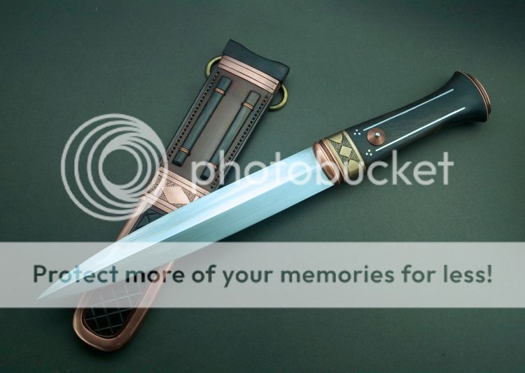

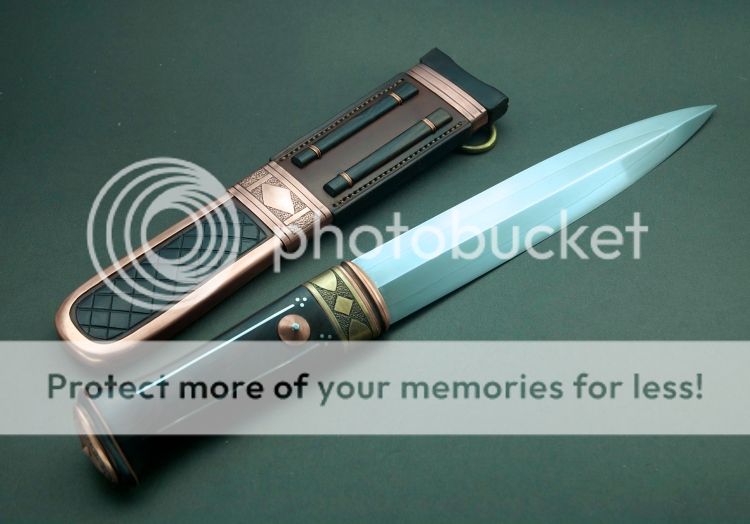

So here is what I came up with.
(please note that the copper on the sheath was done today so it will come to match the colours on the handle soon)
The blade is W2 at about 9 1/8" with and OAL of 14 7/8". Blackwood, lots of copper, and leather and deerskin lined sheath. The pin and handle inlays are stainless. Maybe next one will be in silver but I wasn't prepared to risk silver on my first go.

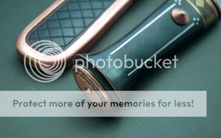

That butt pin is filed to a diamond shape to match the collar...
It's hard to see but the edge of the cone is coined as well
