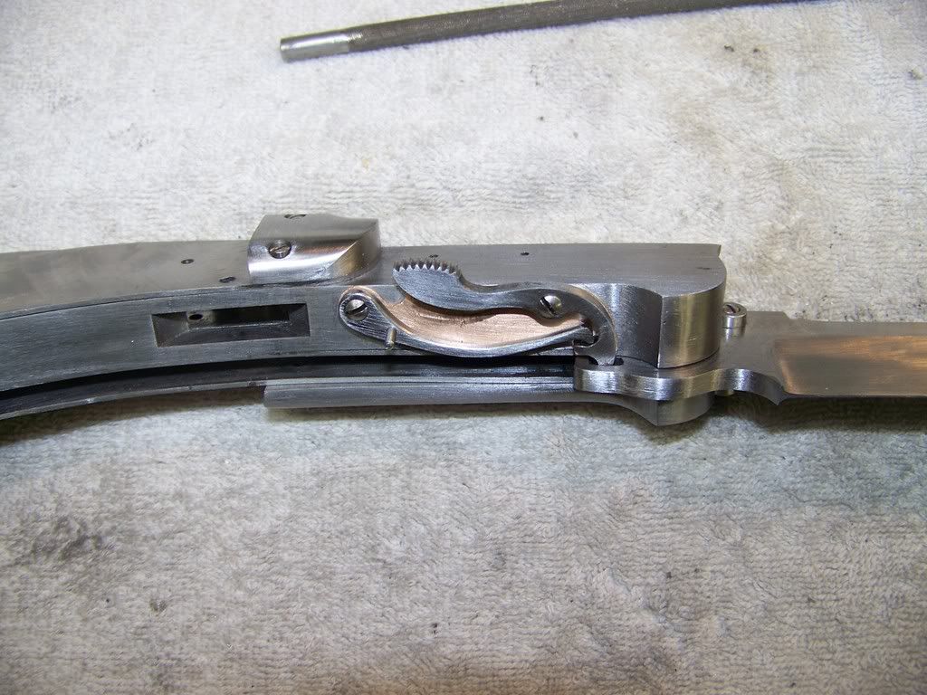

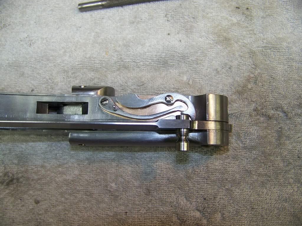

I think I've ironed out some wrinkles in the lock. Its not easy inventing my own blade lock as I cant use anything modern like a liner lock on this one. The spring tension is critical because it cant be too strong or the drag will over power the assisted opener spring but it needs to be strong enough to move the lever into the blade tang with enough engagement to snap and seat into place or there is slack in the locked position. Anyway after a couple days of fussing around with it I think it works good now and looks old. Every thing mounts and moves on a phosphorus bronze shim plate.
Oh and I made the blade stop/thumb bob too and ordered a 5mm emerald for it.
I have to agree with IG on this one. I've really enjoyed your last few projects but this thing is great! I'm paraphrasing but, "I had to invent my own blade lock system, no big deal." Who does that?! Bruce Bump is who! :D
That lock looks more modern than a liner lock! Nice work, Bruce! I look forward to more pictures.
