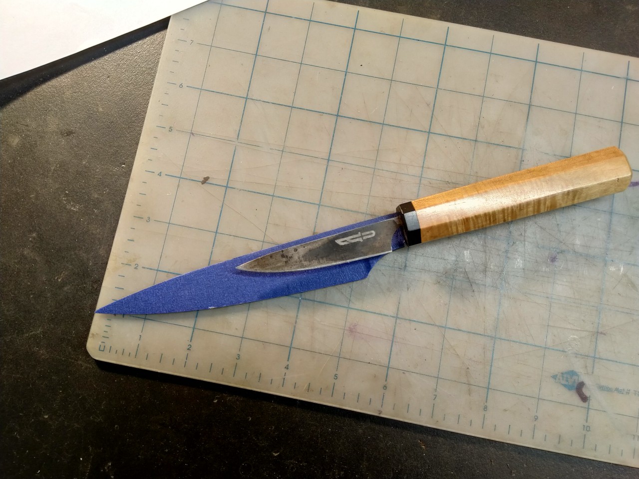

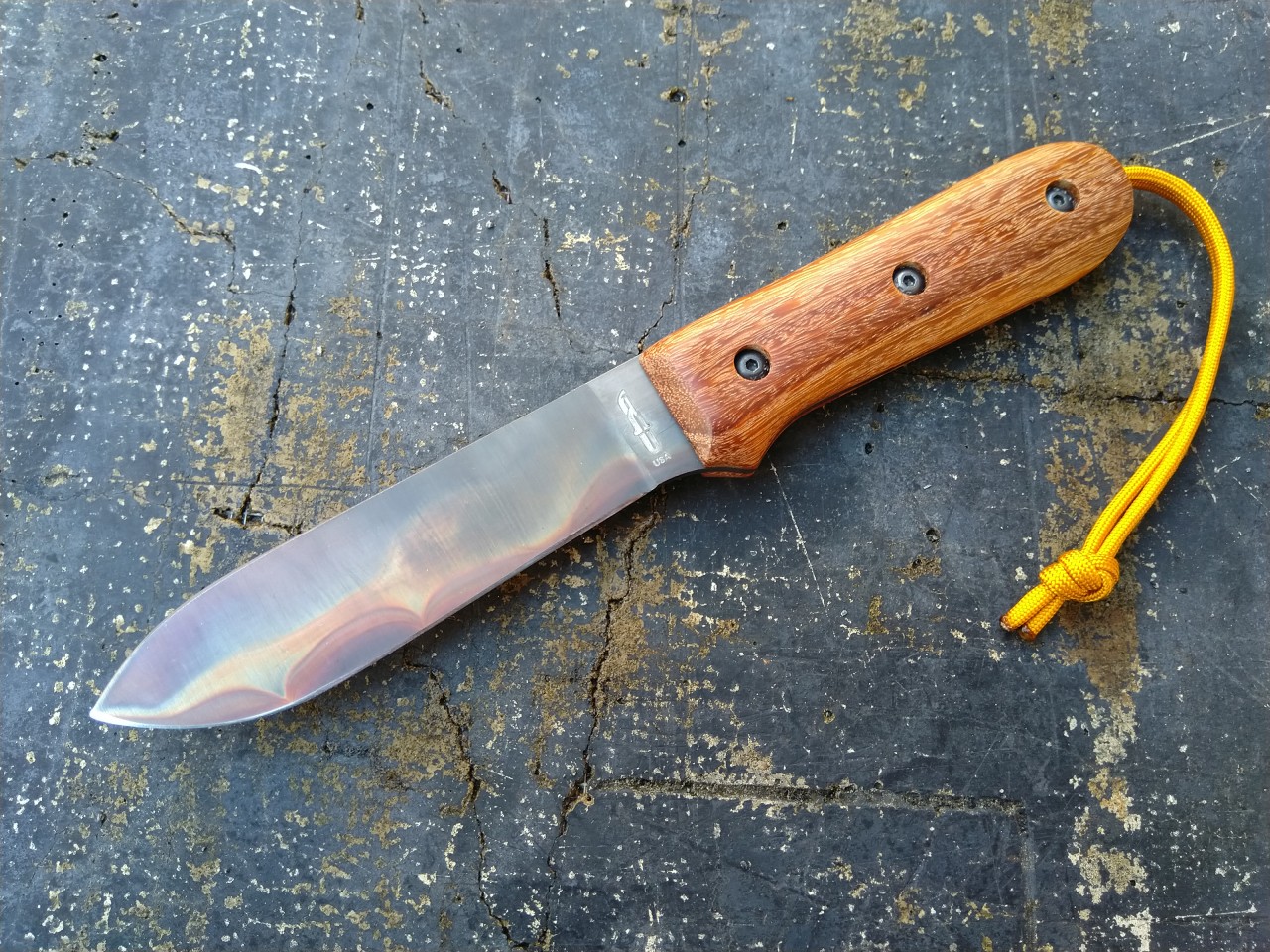

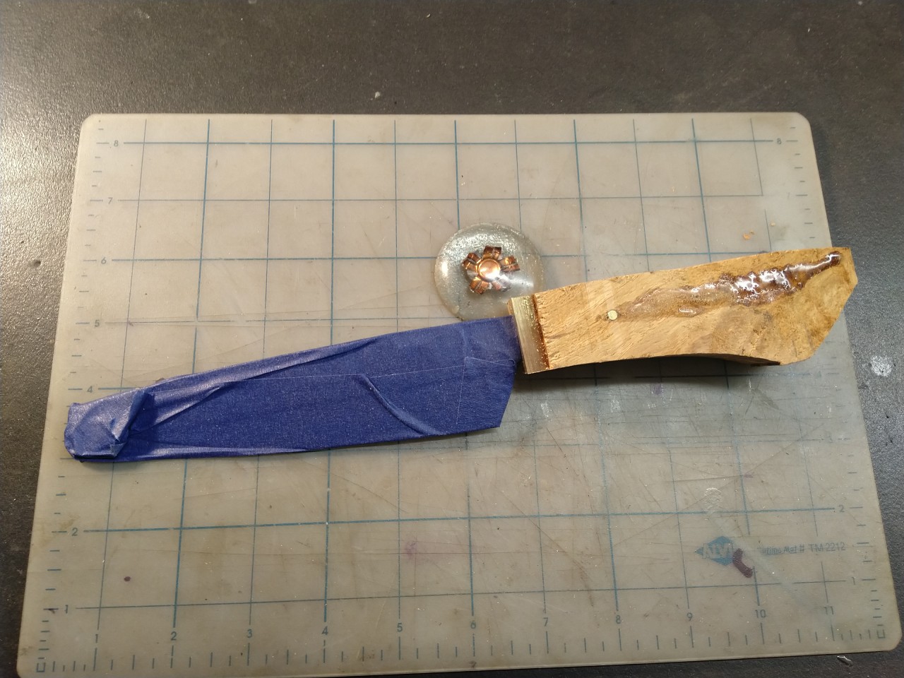

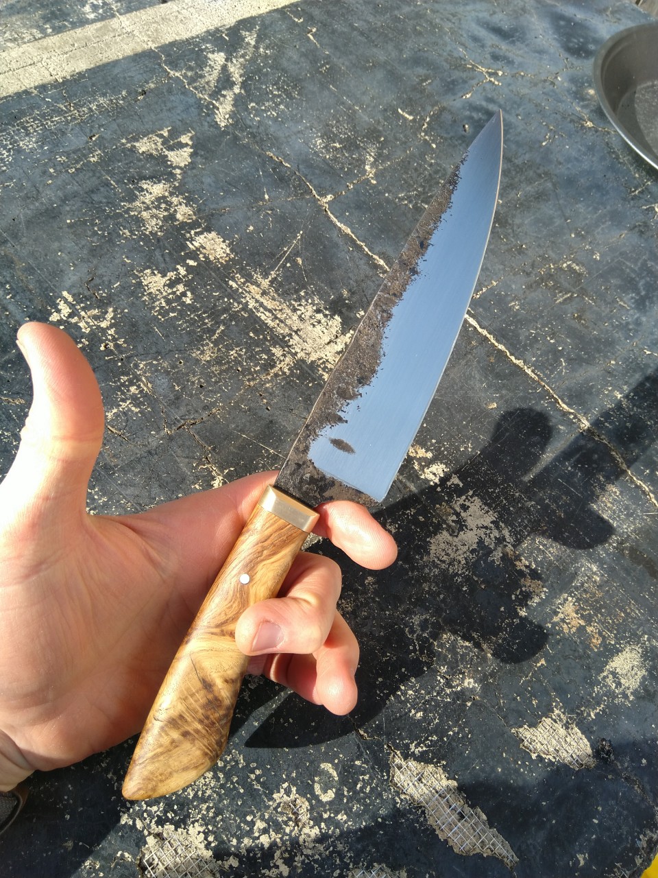

And she's complete:
daizee daizee Yeah, that turned out real well!
Some of you guys here are inspiring me to take some baby steps.... haha
Thanks, guys, glad you're enjoying the puppet show.

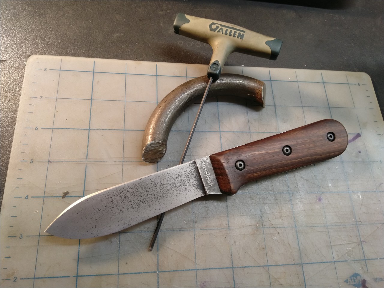

Finished the second temper on the SpringHart this morning and put an edge on 'er in the shop just now. Holy COW, this steel takes a great edge! :eek:
Left the tang a little thick, as it's an experiment. Got a nice heft and fills the hand a smidge more. Solid piece!

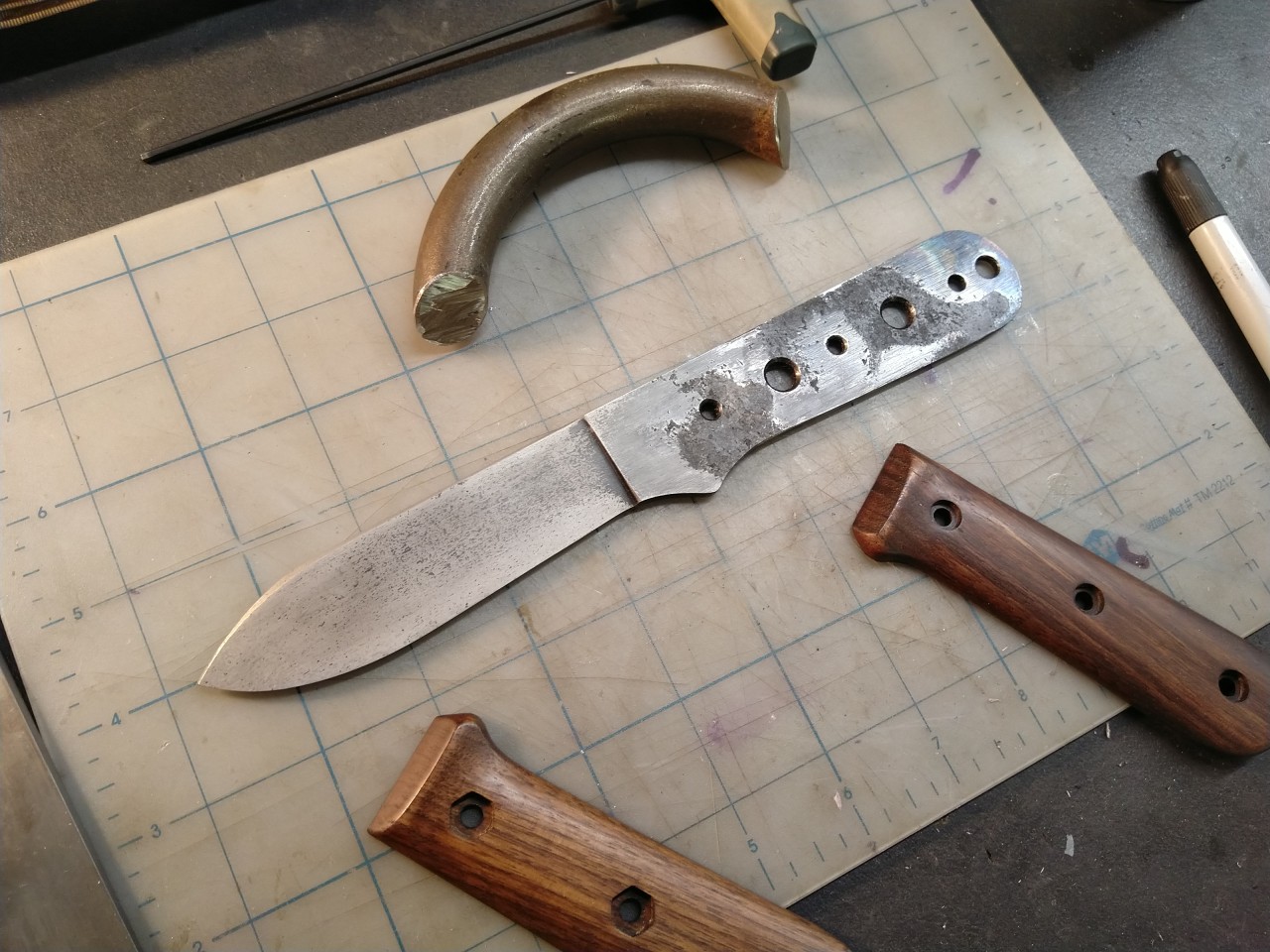

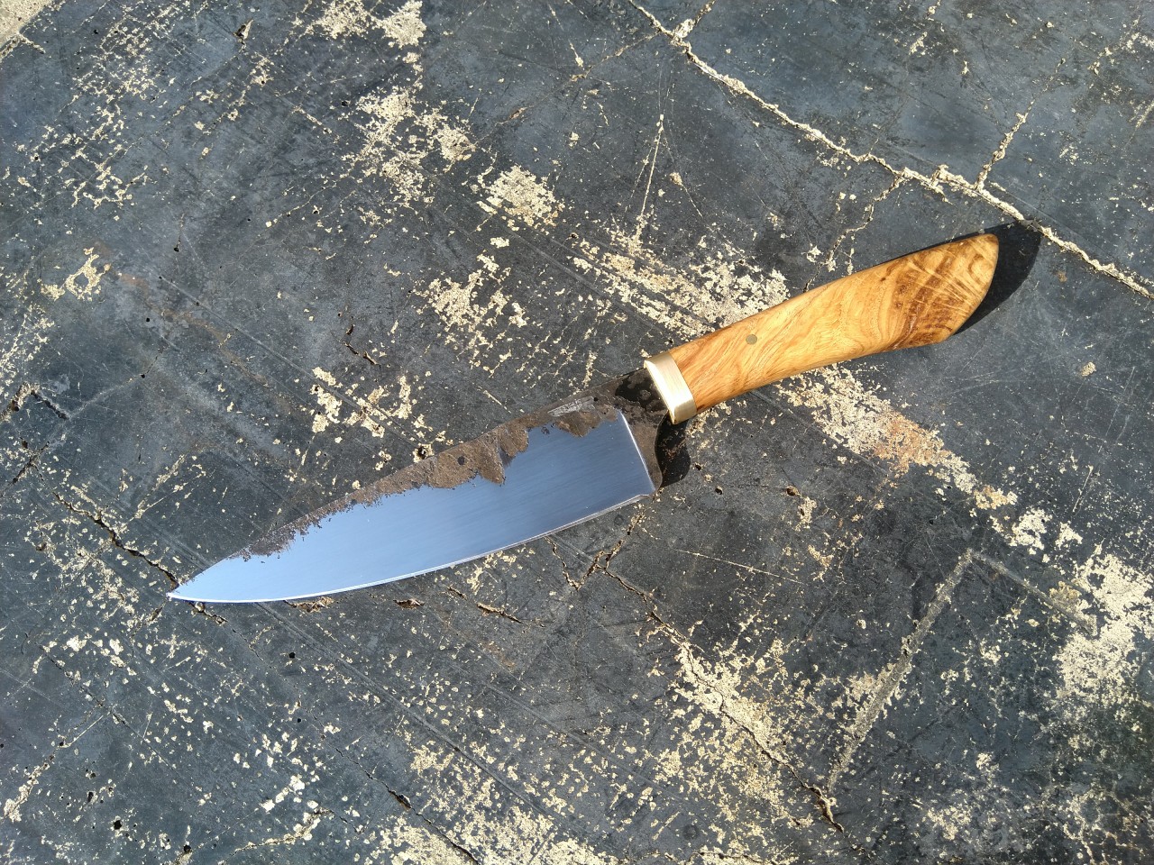

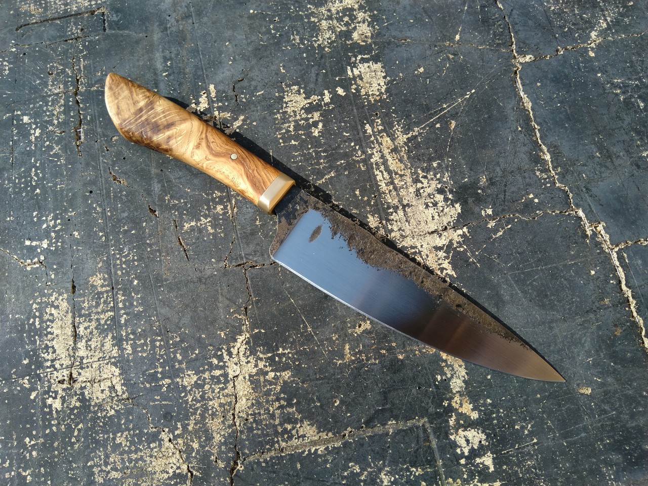

my other Saturday night project:
Osage orange scales, copper pins, blade hammered out of a grain auger from a local brewery.
flat saber primary grind with micro bevel, top half convexed towards the spine, distal taper to zero at the tip.
anvil marks left on purpose -- thinking about doing a vinegar soak.

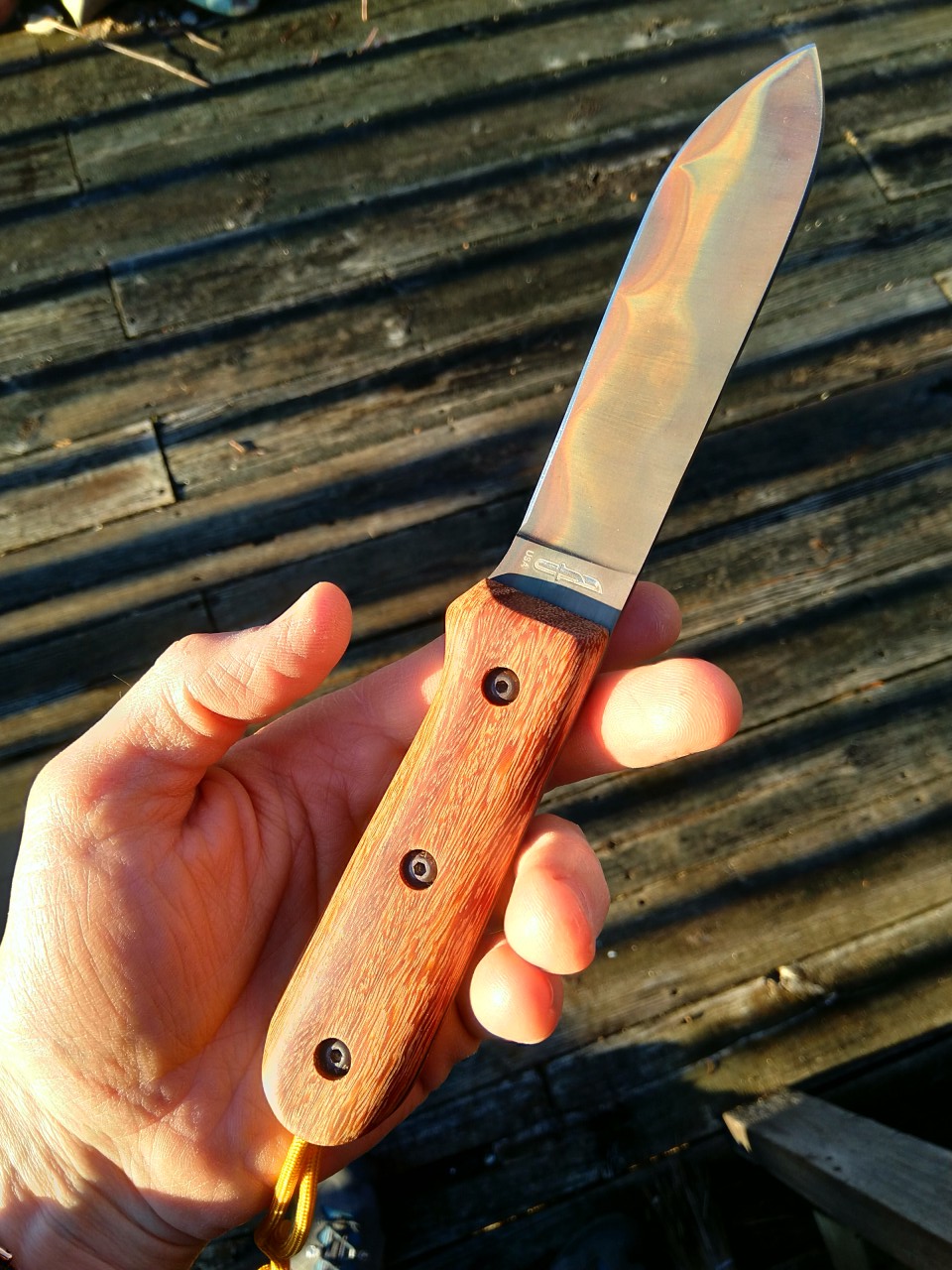

AEB-L AuK5 got some custom scales in Azobe, since I drilled the tang holes sliiightly out of alignment so the factory scales sat kinda funny:
daizee daizee Really Pretty! LOVE that grain too!
IDK if you ever seen my mods on the 62, but I found some Wonderful brass hardware from LeeValley that would look Gorgeous on your blades....I posted pictures and part numbers, but so far Mine is the only one to use them.... idk why?
They unfortunately aren't "drop in ready" I had to open up the counter-bore's .... but with Your skillset that would be easy for you!
They are by Far the best looking hardware for the 62 I've seen to date. Nice, warm buttery brass......Let me know if you wanna see some pics..... I know some are buried here in the Many 62 threads....hahah
A good brass would be nice, but they don't usually come in the "right" fastener types for my taste. Did you find brass button head screws with a symmetrical drive type?

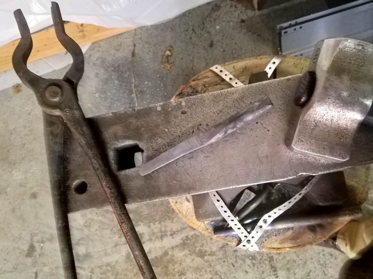

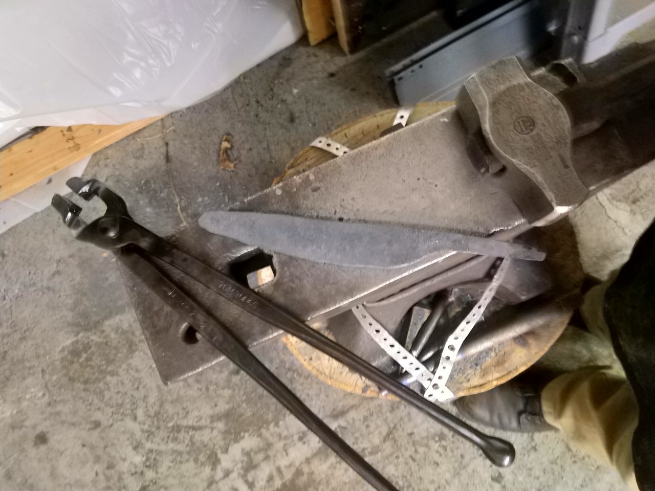

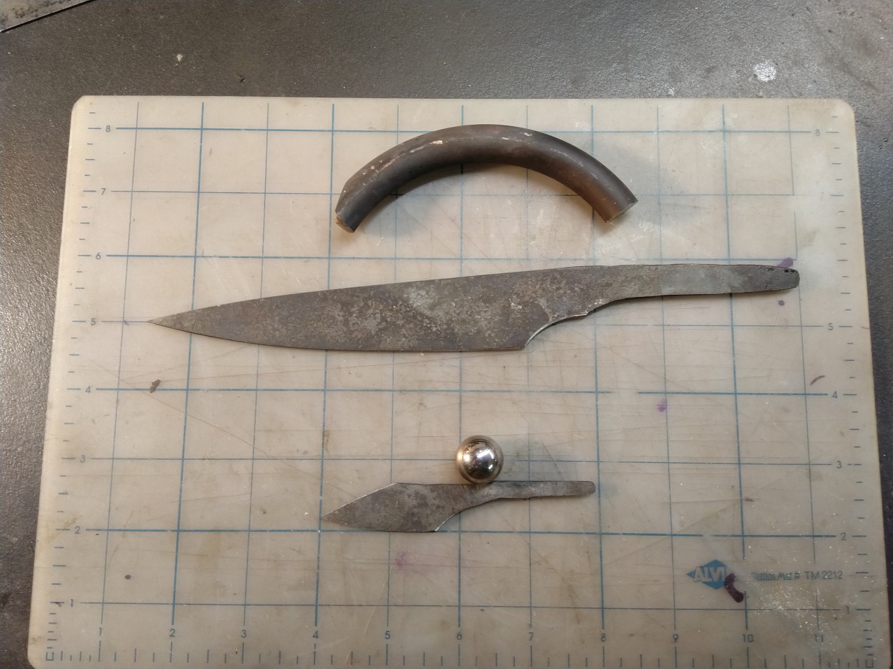

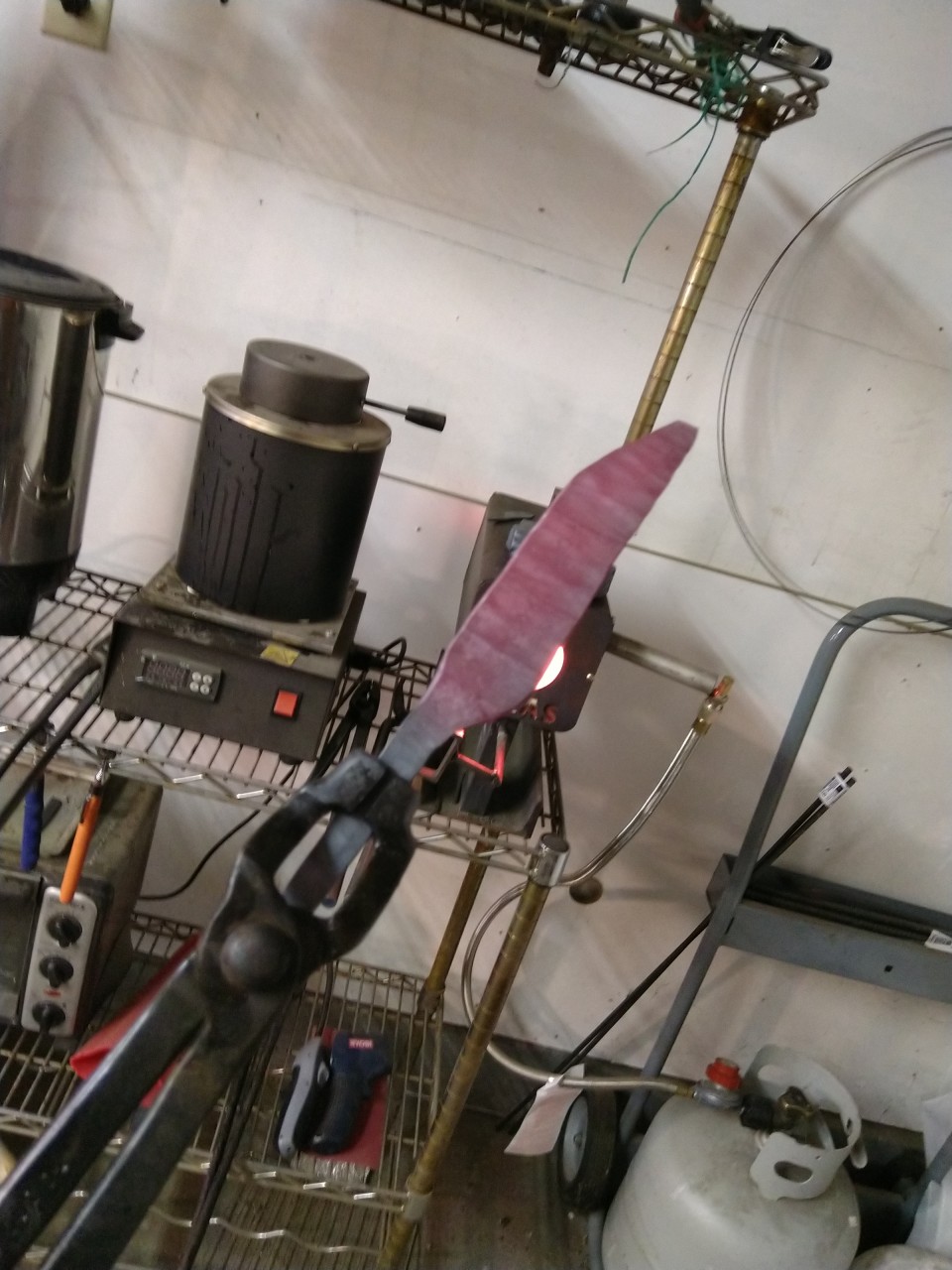

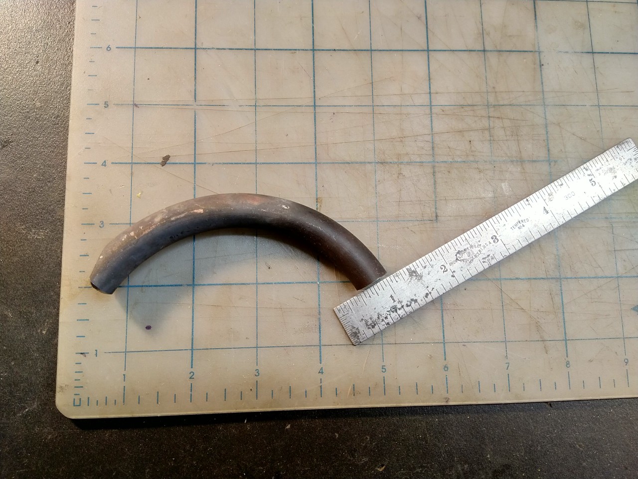

So Saturday night, Hans gave me about 9" of a piece of suspension coil spring from a Volvo X70 that came out of the shop. We'd burned the paint off in the woodstove the week before. Last night I buzzed off 4" of the segment and immediately began what I'm affectionately calling a "Swedish Toothpick":
First pic is actually the remaining piece of the spring, a bit longer than what went into the forge:

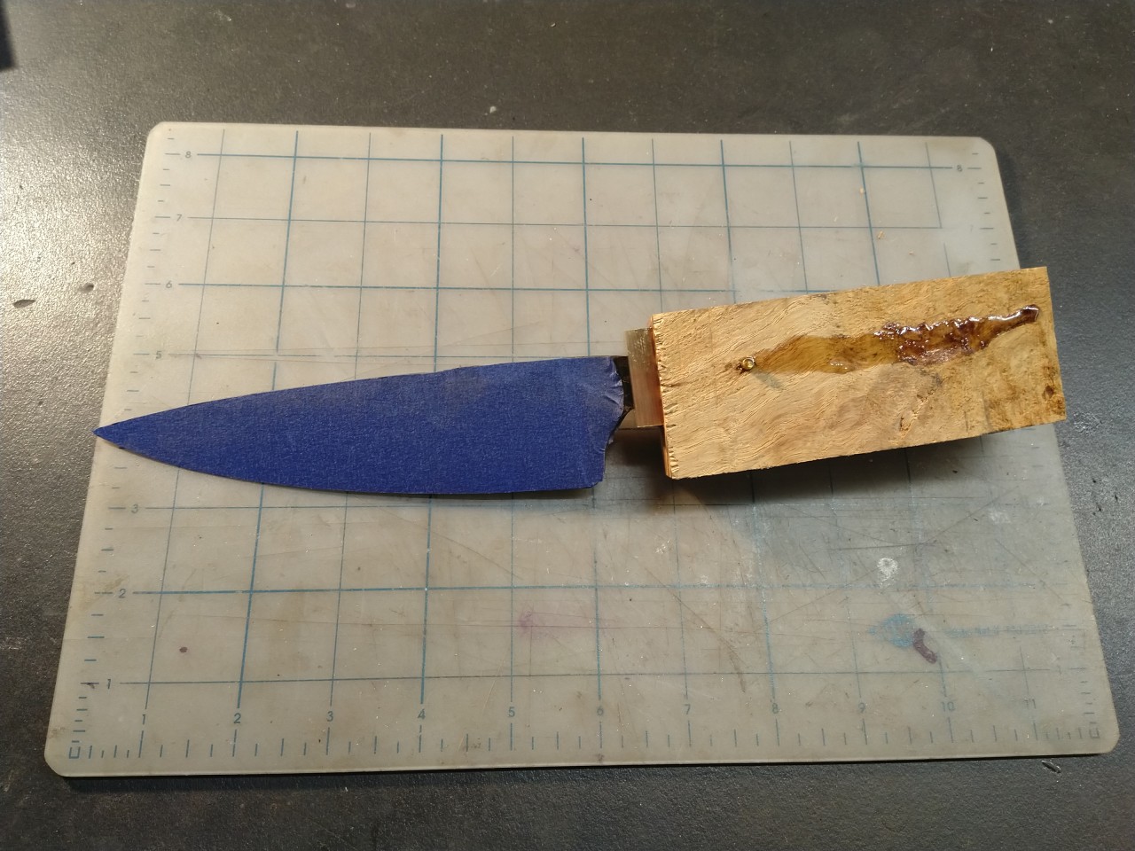

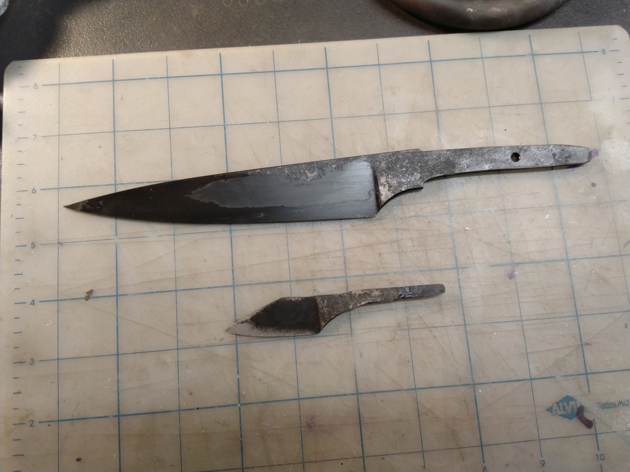

Now for handle options... any votes?
