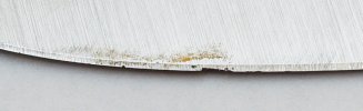

So I ended my test early, as the results were getting fairly obvious. Pictures below and attached.
I had the knife submerged in water with salt dissolved to the saturation point. This definitely constitutes abuse of the knife - that level of salt is completely unrealistic in any real world situation - so please consider this a worst case scenario. I'm certainly not suggesting that this would happen to any LC200N knife under any normal scenario.
The knife was straight from Spyderco, wiped with alcohol to remove any oil, and then submerged in salt water for 4 days. Afterwards, I rinsed it and wiped it with a cloth - nothing more aggressive. Weirdly, it had just one area of damage, but that area was pretty bad:
Big rust stain, and multiple chips in the edge that weren't there when I submerged the knife.
Full pictures of the blade are attached. The black streaks are gunk from when I was testing the remaining edge cutting through cardboard, including tape. What's odd is that the rest of the knife, including the edge, held up very well - dare I say, perfectly. That's kind of inline with what the OP shows - certain areas of heavy staining, while the rest of the blade appears fine. Contrast that to the corrosion test videos from Cedric and Ada or BladeHQ, where the knives that did rust had staining and speckling evenly distributed across the surface of the blade.

So, I dunno what to make of it. Most of the blade was fine, but one spot got destroyed. There were some theories earlier in the thread that the rust spots might be from inclusions in the metal, either from the refinery itself, or from the grinding process. Zknives lists LC200N as manufactured using the electroslag remelting process (description here: http://www.zknives.com/knives/steels/steeltec.shtml#ESR) which certainly sounds like it may be prone to inconsistencies in the final product, but I'm just guessing from their brief description.
What's also interesting is that we now have three examples (the OP's comments, plus the Cedric and Ada, BladeHQ videos referred to earlier) where the Spydiechef held up much better to corrosion testing. In particular, BladeHQ had a SpydieChef submerged Great Salt Lake water, which likely isn't too far off from what I was testing with, especially once some of their water evaporated and concentrated the salt. As I mentioned in an earlier post, the mule and the Spydiechef are made in different facilities, on different continents, so there could be any number of factors that would lead to
different results.
Just based on this, I'd have to conclude the following:
  • LC200N appears to be generally more stain resistant than regular stainless steels
  • With data from two production batches (the mule and Spydiechef), I don't think we have enough data to start figuring out the inconsistencies. Hopefully Spyderco can learn more once they get the OP's blade, and subject it to additional testing. I'm hoping some Spyderco Tusk users can chime in as well
  • Spyderco's warranty and customer service are excellent, as the OP found. If you do buy an LC200N blade, and it corrodes under normal use, it sounds like they'd replace it. Based on that, I wouldn't really have any major concerns buying a Spydiechef or Caribbean for use in salty conditions
Hopefully we'll know more once the Caribbean launches. The Spydiechef was a bit of a specialty knife - I'm hoping the Caribbean sees more use in salt water conditions so we can get more real-world data.
To add, I was also testing an AEB-L blade and a Vanax blade at the same time. The AEB-L blade got destroyed in 4 days - the edge was almost completely gone. Not even worth trying to resharpen it - I trashed it. The Vanax blade? Perfect, as if nothing happened. That may support the theory that the problem is due to inclusions or inconsistencies in the steel manufacturing process, as Vanax is a powder steel, which should lead to a much more even distribution of the components.
different results.

Sure, not a problem - I was as curious as anyone. I was planning on scrubbing off the rust, but now I'm thinking it may be useful to put it back in a salt solution and let it continue corroding. If the theory that it's rusting due to inclusions or inconsistencies holds true, then if the bad spots fully rust out and are scrubbed away, the remainder should be as rust proof as LC200N is expected to be. It may not be final and incontrovertible proof, but more evidence doesn't hurt.
I am still looking forward to my first knife in LC200N, and these slight stains (across all knives shown/referenced) haven't tempered the desire. I am fine with M4, so LC200N should be plenty stainless.
Absolutely - there are plenty of tests showing that the Spydiechef is as rust proof as you'd expect it to be. I don't know Spyderco's manufacturing dates, but I would guess that all the LC200N mules were made in one big batch a while ago, and the ones they're selling now are leftovers from that batch. The Spydiechef would then have been made separately, probably from steel bought separately, using the lessons learned from the mule itself. Whether it's because it's a different batch of steel, or whether those lessons learned made all the difference, it sounds like the Spydiechef is a different beast.
I'm tempted to buy a Spydiechef and repeat the test, but $200+ is starting to get a little above where I'm willing to destroy a knife to satisfy my curiosity :)
