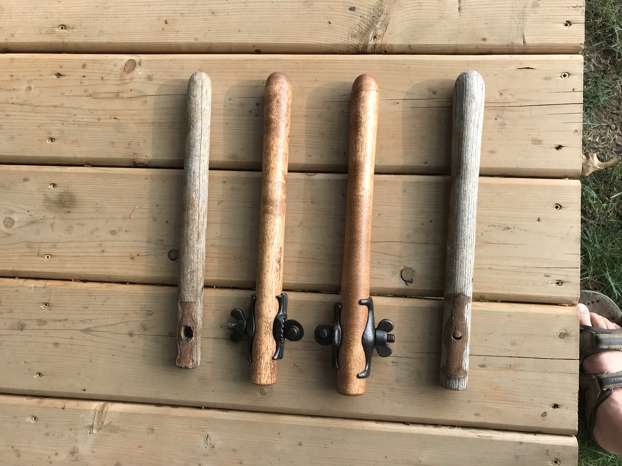

I pulled the saw handles out of that ammo can full of BLO/mineral spirits this evening – they seem… heavier. Little WD-40 and a wire brush on some hardware.

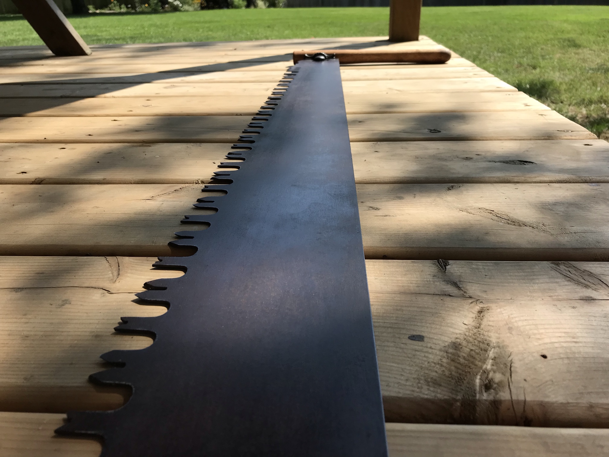

I completed cleaning up my saw as far as I’m going right now. The handle hardware I cleaned with a wire wheel and then immediately cold blued them, then put some oil on them. Came out a nice dark color. The handles I turned down so they are tapered in the middle and then stained and oiled them. The blade itself was a lot of work just to get this far working by hand only. I used the WD40 and sanding blocks as recommended but I didn’t go to bare metal. At this point it’s a dark brown but feels very slick when running your hand over it. No sign of an etch yet. The teeth still have their set and seem sharp, probably wouldn’t take too much work to get it to cut half decent. But I know that properly sharpening a saw like this usually takes a lot of skill so I’m not going to attempt it yet and mess it up. Thanks for the help!
Hmmm. Two cutters/raker on a perf lance, that's atypical. Looks like most of the bridges have been filed out.
Are the Bridges the the little parts that connect the teeth together, like the ones at the ends still have? I don’t really know what’s typical or not except that I thought I read somewhere that 2 teeth/raker was more common in the east and 4 teeth/raker more common in the West. I fount the saw here in Ontario, but have no idea of its origin.
The bridges are the metal connectors between the teeth. If you look closely, you can probably see where they were filed away on your middle teeth. That's fairly common on worn saws, but there's plenty of life left in your blade.
The stouter Champion tooth style is a two cutter/raker design that's pretty universal, but for the thinner lance toothed saws, the four cutter/raker design is much more common everywhere.

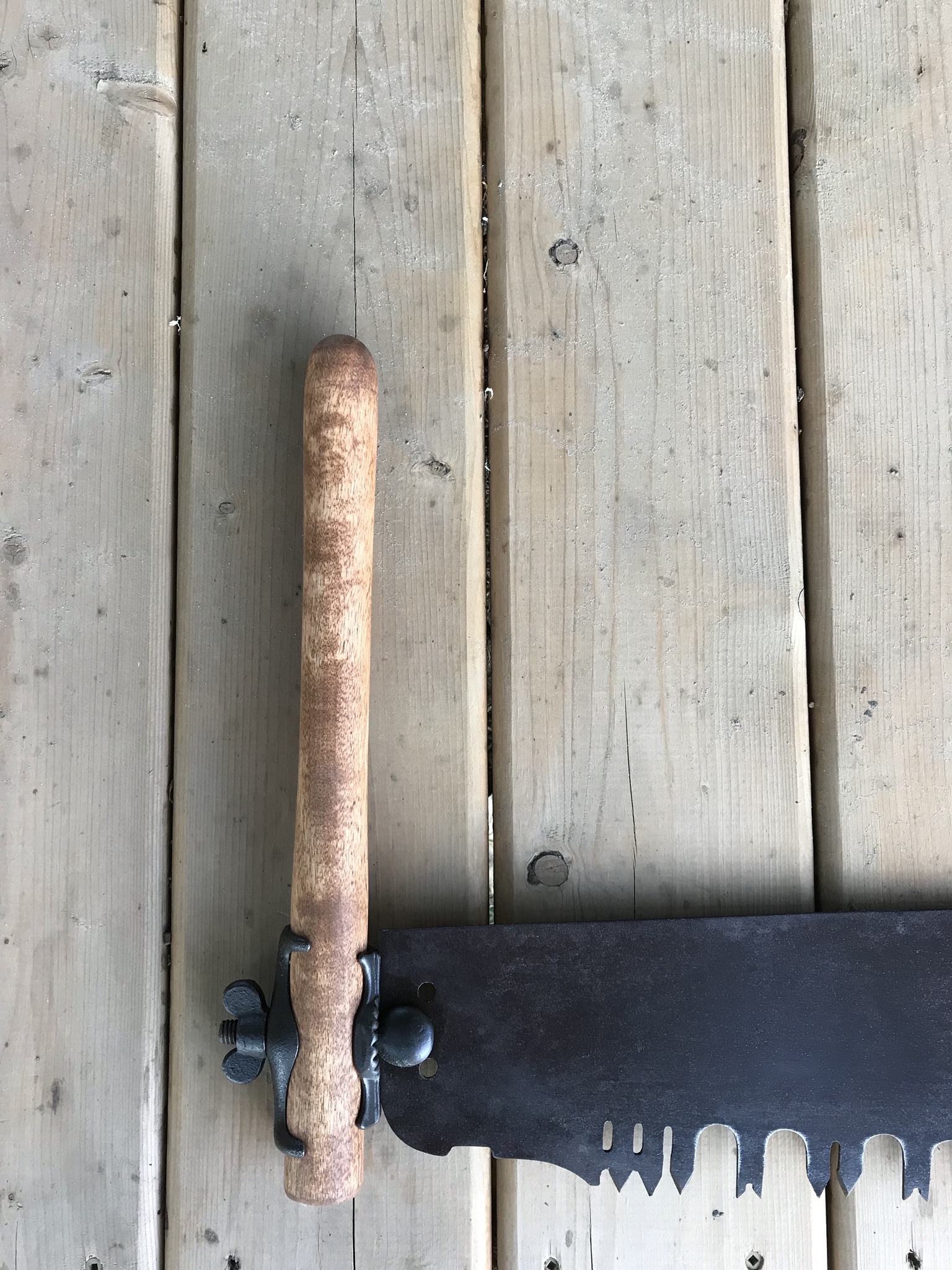

Reeled in a 60” Simonds Royal Chinook 395?
The older guy who sold it to me said it was his father's and the handles are original to the saw as far as he knows, for what it's worth.
Chinook
These cutouts on either end - set up for multiple handle options?
