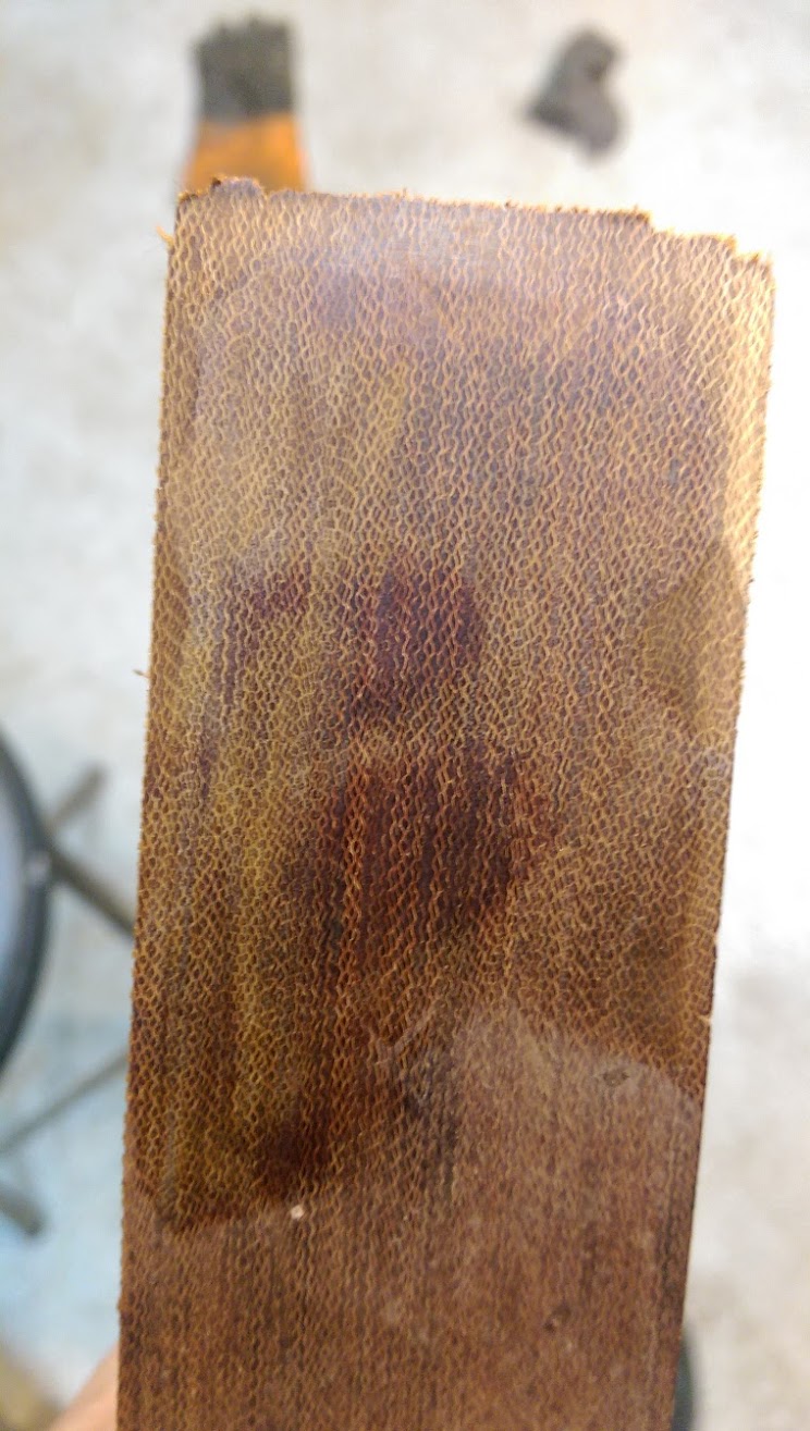

EcIhjAX39i7NCl1EA_B7l5erK5h0f4mtIdd4gqo9ZJw=w744-h1315-no

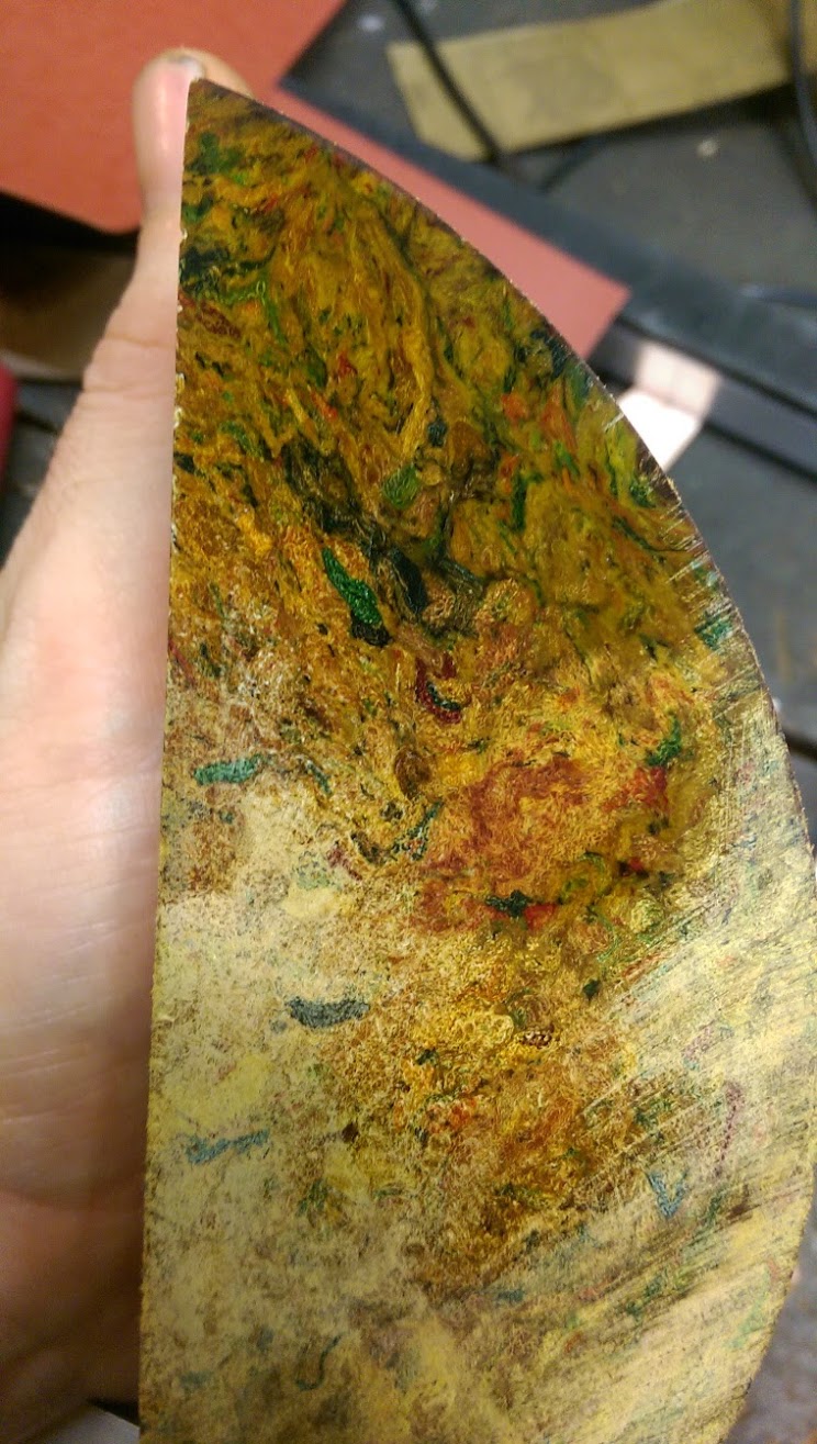

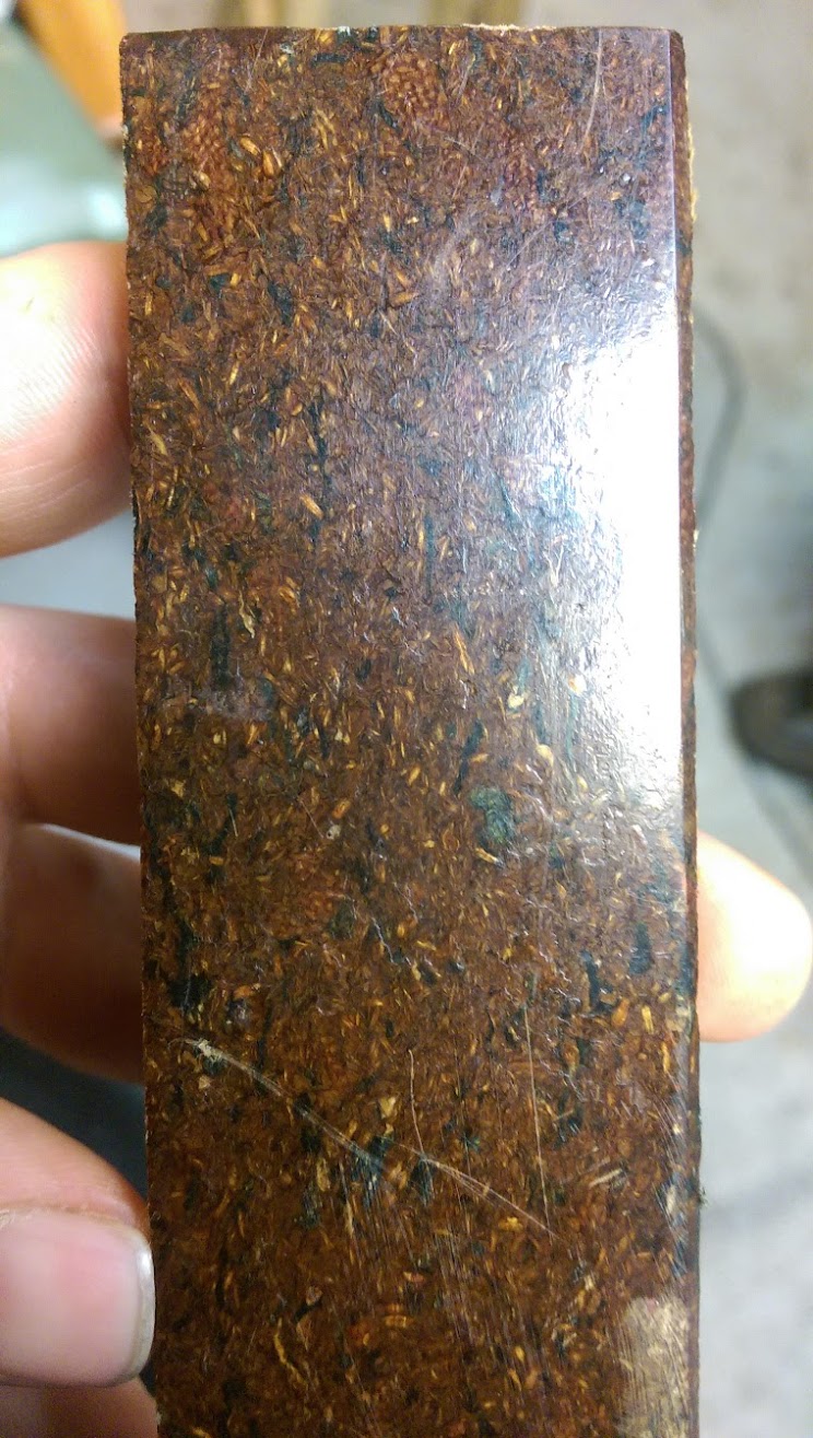

Honestly this stuff looks like rag micarta, and it's tougher than bakelite (I sent a piece flying off the buffer and it didn't chip), and kind of smells like micarta when grinding but it's from big round balls, not sheet.
Ok yeah, I think this is actually rag micarta and not bakelite, it's sort of fibrous, and smells different than the other catalin/bakelite items I've got. Absorbs a bit of WD-40 on the surface like micarta.

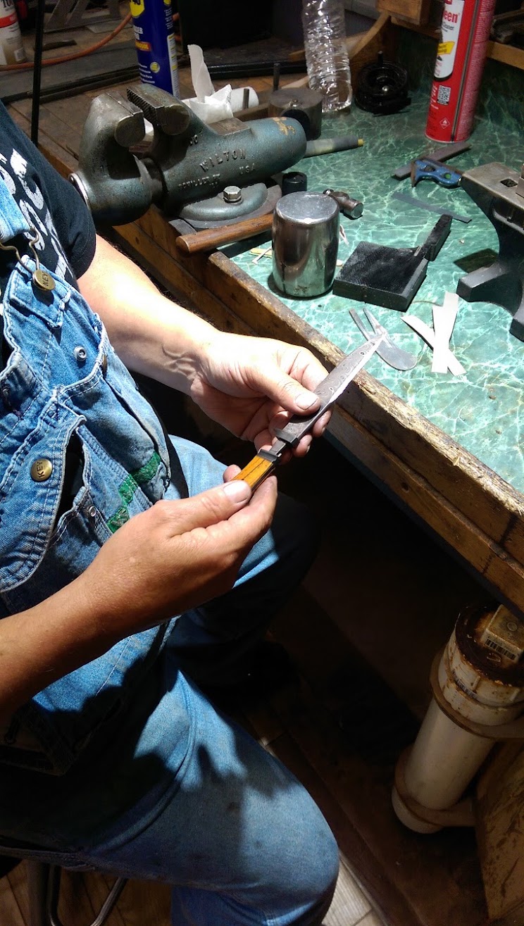

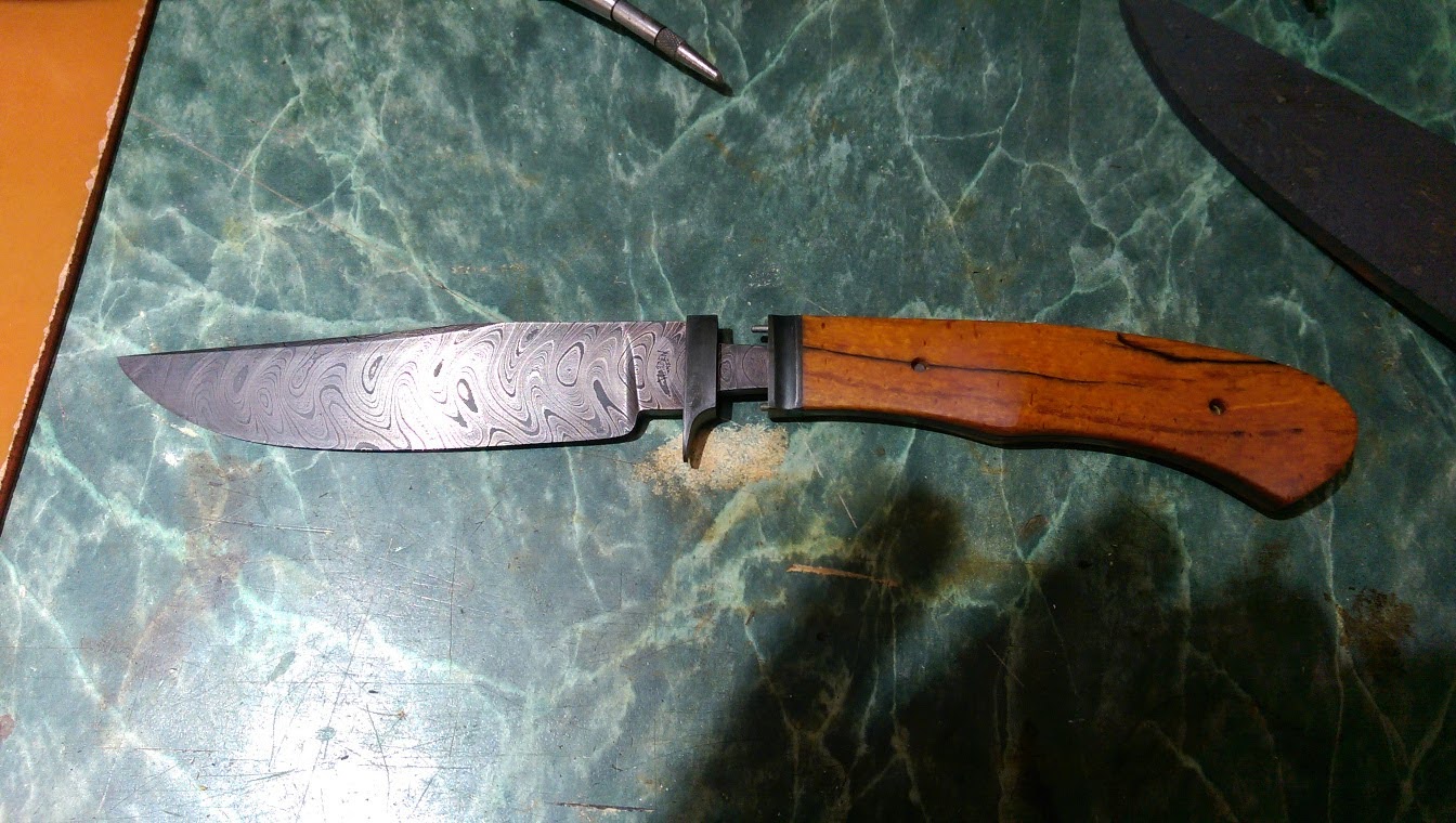

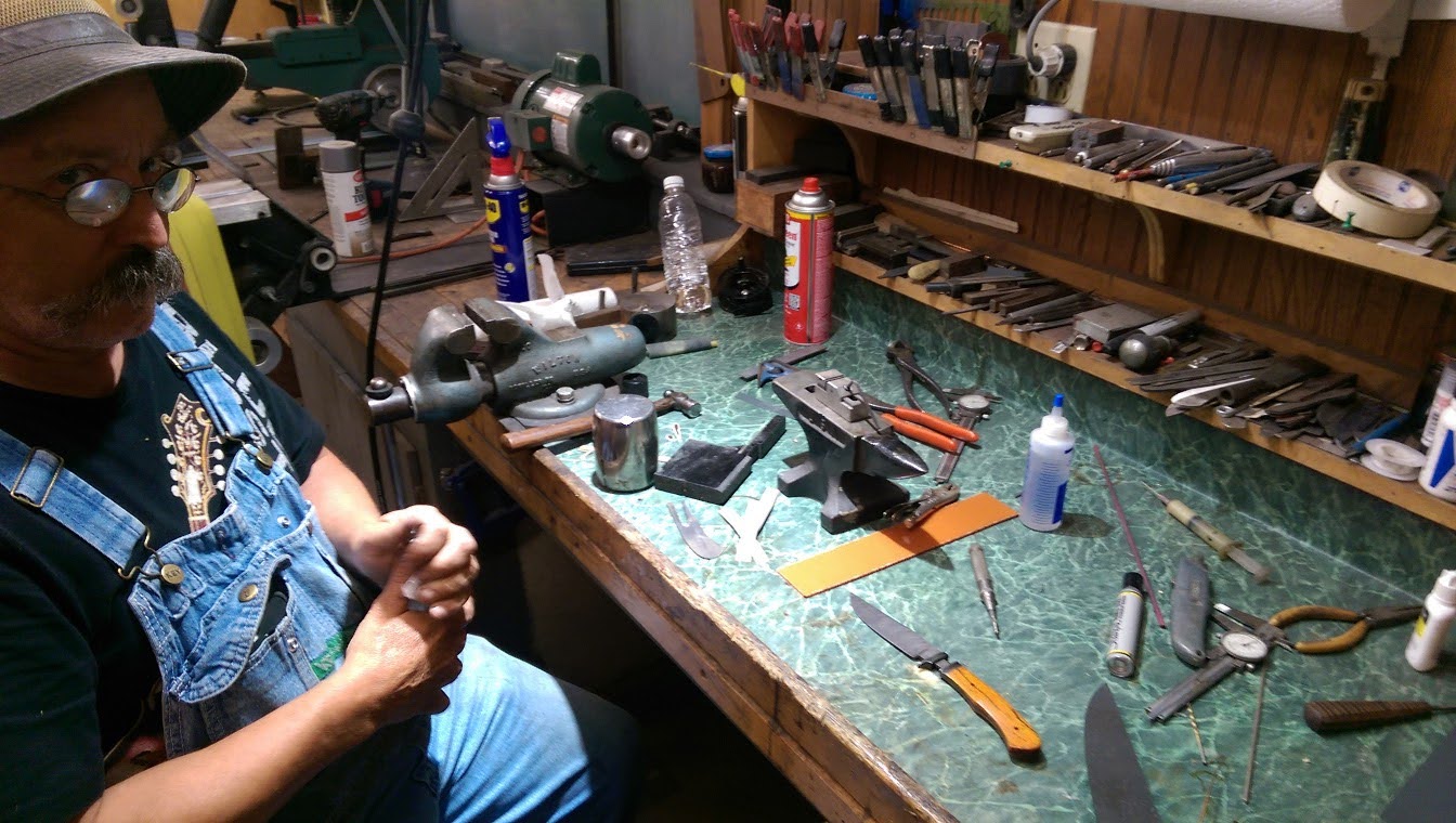

Went to Big Dan Warren's place tonight, needed his help on something and gave him some of the butterscotch micarta I got from John. He was working on a frame handle:
uF6R6u76-4UvSkRaslpnnUZIF0KZVjlia-zdWArpoAI=w1344-h760-no
T7Z-Nmk5wngItHgsu5V6gsopAO8jT_XosoBwPWDBoRo=w1344-h760-no
You can't tell from the photos but the frame is tapered:

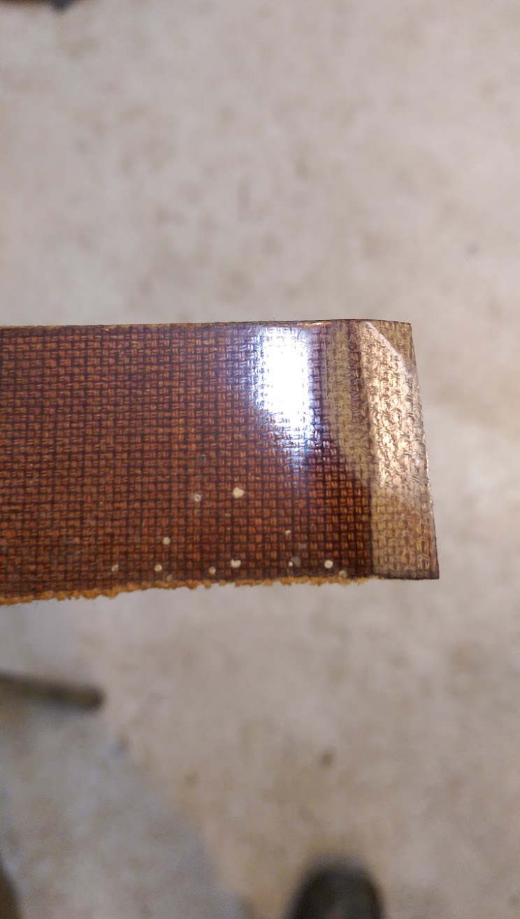

He verified what I thought, that the material I just acquired was definitely rag micarta, and he sent me home with some more rag micarta:
nN108TiPaVhMwDBubxGggUCODL8u5mJiYbd6idFaN2o=w744-h1315-no
Also, some more old canvas micarta, this stuff is 1.5" thick:
qIa8T6Byq1JNC_waNfM3t80AStYSC00ExWldM9ZE51Q=w744-h1315-no
AyHI8y5PqQm3gj-N_a29mZLJCpcCyXM6BjG5B9QuL9I=w744-h1315-no

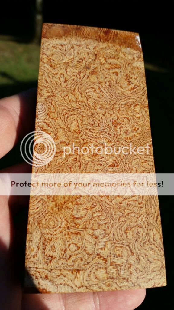

I have a knife being made by JD Ware (not the one below) using some lovely vintage micarta. This was ivory when it was purchased over 40 years ago from Angus Campbell. Gorgeous stuff.
JD's pics, not mine...
I've got some unique stuff that looks like little bits of material-similar to rag micarta, but its all the same color. Kind of a yellow color. It was a really odd shape and i managed to get a block out of it. I've never seen material like it. I'll try and find it over the weekend for a pic.

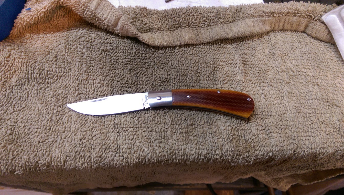

Here's one I'm finishing up using that vintage natural canvas material from Ray Kirk:
